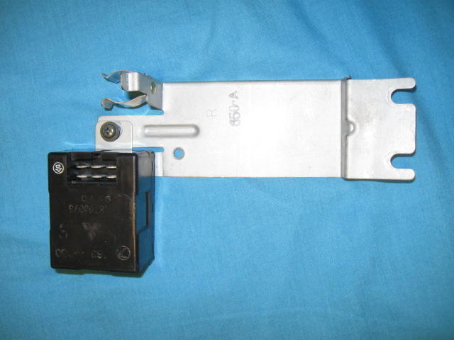

Just had a look, think I have located it. Its in a bitch of a spot, right up under dash. Remove drivers side kick panel, attached to a metal bracket which is bolted up with bonnet release handle. I could'nt get camera in there for pic but standby for a pic im going to take of a spare that I have! I could'nt even get the connector off to try and start car to see if I get the same symptom. ;)

I believe this is what you are looking for....

Thanks fujifan,,your a legend..I will get straight onto it.Very grateful for your help,,cheers justin..
