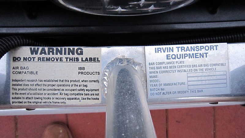

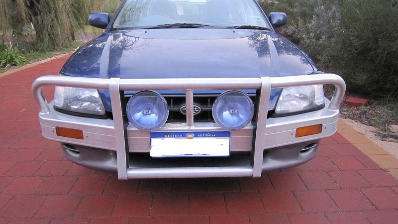

Post by dale147 » Thu Jul 08, 2010 10:30 pm
G'day, I've got an Irvin make of bull bar on my Outback and it's air bag compatible, here's the link.
http://www.irvinbullbars.com.au/
Dale

Post by dale147 » Mon Jul 12, 2010 7:41 pm
Here's my bull bar, it's hit 2 roos so far and has been ok each time
