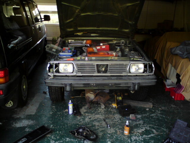

Post by Pommiebrat » Tue Feb 09, 2010 10:56 pm
Attached is a picture of what I've got. I've seen pictures from the Hatch patrol of early ea81 model hatches and wagons with the same grills but can't find the correct corner lights anywhere.

Post by dfoyl » Wed Feb 17, 2010 5:58 pm
You have a 1981 grille. Any 1981 "MY" indicators should fit. Good luck finding some, I recall seeing 1 1981 MY at a wreckers in the past 4 years and that was about 3 years ago. I actually have a decent 1981 grille sitting around here but no indicators :(
Simple rundown (ignoring GL/DL spec, Japanese dates vs AU dates vs USDM dates vs UK dates):
1980 : Single round headlights (1979 in Japan)
1981 : Single rectangular headlights, >=====< grille
1982 : Single or dual rectangular rectangular headlights, straight-through \=====/ grille
1983 : Single or dual rectangular headlights, honeycomb grille
(I know some 1981's came with round headlights, etc - these are approximate year dates to keep it simple)
I'd suggest putting a plea out on usmb as that's about your best option for turning up a donor vehicle - maybe one of the regulars like edrach or barracuda will have something in their parts pile.
Dean.
