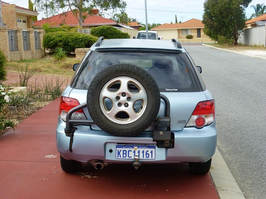

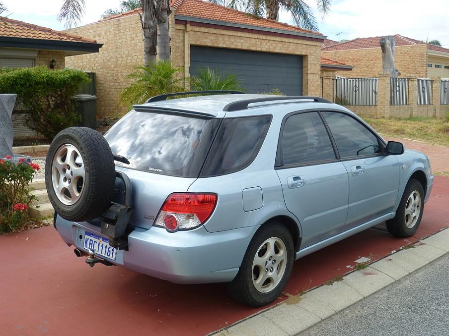

After much delay due to the recent Perth heat wave, I finally extracted a digit yesterday and got my rear tyre carrier mounted.
It is from a Mitsubishi RVR, and I strongly recommend it as a base to work from.

Awesome work there
Just need to refine the bumper cutting and it will look factory.

Yeah shame you had to cut into the bumper like that but otherwise it almost looks factory.
Mounting it the way I decided to go, that is not modifying the RVR carrier bar (about 120mm square tube) I was always going to have to cut the bumper to fit over it the bar.
People with more fabrication (any as opposed to none) skills than me could have done it much neater, but I'm happy it's never going to fall off as it is bolted to the chassis and welded onto the tow bar.
I will clean the bumper up a bit in time, but have already mounted the standard plastic trim back onto the carrier and the right hand side hole is pretty much hidden when closed.
