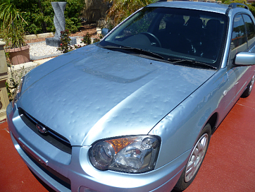

After a heap of watching and waiting, I located a one owner, 69,000km 2004 Impreza GX wagon with the dual range gearbox. It has some superficial hail damage, but I got it for a song.

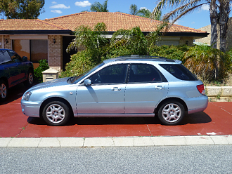

Firstly I had the car rego'ed and insured, then added a set of 15 inch alloy's with Bridgestone Duellers (205/70s). As a result, I went up a few cm, maybe an inch.

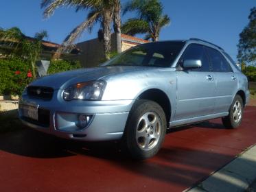

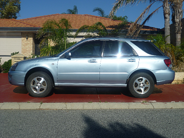

Second stage. I went with the logic that genuine Subaru parts was the way to go, and pretty much everything i used was from SF Foresters. I added self leveling front and rear struts, cross members (including g/ box), and brake lines. Huge thanks to Jap Wholesale in Wangara for thier help. I ended up with about an extra 2.5 inch of lift.
The next stage will be lifted Kings springs, sump guard, spotlights, and if anybody wants to sell one, a rear spare carrier. I might also fix some hail dents (maybe...).
I've attached photos for you to check out before and after.

Hi and Welcome back Jayd
Your Impreza hatch looks good.. what do you mean by stages of the lift?

In regard to the 'stages of lift', it's just my way of doing things and how I'm terming it. First I did the wheels. A few weeks later (second stage-today) I did the struts, cross members ect. Next I'll do the lift springs and other bits and that will be my stage three. Let's be honest, it would make more sense doing it all in one hit, but...

Today I fitted a set of brand new Boge Forester struts front and rear and geeze they make a difference over the worn out struts I pulled out, car drives like new again!!!
I've also got my Kings raised springs and Subtle Solutions 1 inch lift blocks in, so the impreza now sits pretty high.

F**K you have more clearance than my Foz and im yet to get stuck with my lift!
Taza
I'll take some photos once my new tyres are on to show you just how much clearance I've got! It is really quite high, like when I bled my brakes today I just slid under the car on my back without any jack stands or anything and still had stacks of room to work. And the new tyres should give me another few cms of lift!

Wow that is some SERIOUS hail damage...i thought we had it bad over here but that really does look like a golf ball lol. You might be right bout the aerodynamics lol.
Thats a great build you've got going. How does the extra height affect the onroad handling?
