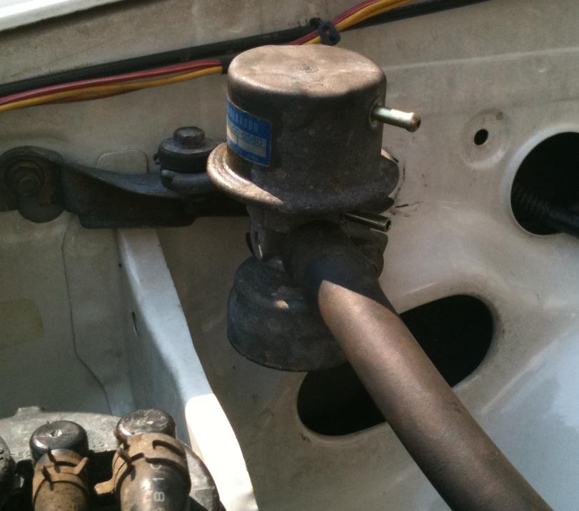

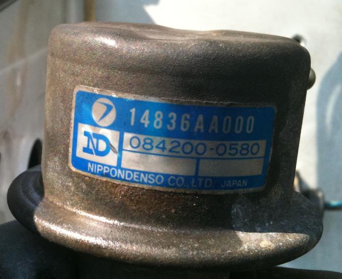

with the EGR thing, below is a pic of the device it goes to. What does it do and where do the small 2 outlets go? Seems air related.

5) The photo you have provided is that of an Anti After Burning valve. This has nothing to do with EGR system. On the EA82 carb models, there was either EGR (85' - about 89') or Anti AB (89' - 94') fitted to engine, not both. At some point your cylinder heads have been swapped with those from an EGR equipped engine, hence the mess.
If your year model originally was fitted with the later, then all you have to do is have it correctly plumbed up. The EGR is the worst of the pollution gear because it leads to excessive carbon fouling of the inlet manifold and heads!!

5) The photo you have provided is that of an Anti After Burning valve....J
Yep out off the road for about 18 months. But not for much longer! And never again after all this drama. Hehe only way to learn hey :)
Thanks for that info re EGR & AAV. "As far as I know" my webber engine was from a 85 vehicle, but it was definitely not original (88 body). It has a dodgy cover over the area that my 86 one has the big pipe going to the AAV. So the 86 will provide the parts (its actually the body im using). If I had my engine crane might be easier to swap the engines again...anyway.
So then the 86 also has a metal pipe that connects to the exhaust flange of cylinder #3. Cannot remember where it goes though. Related to some other emission's thingo I guess. Will swap it all over if it looks easy enough.
2 quick questions, AAV, Large pipe goes to the inlet manifold, where does the small one go (two connect into one but where from there)?

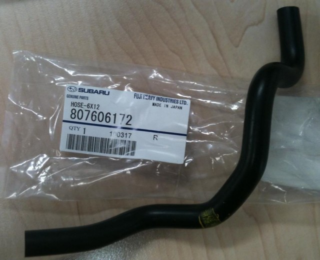

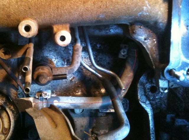

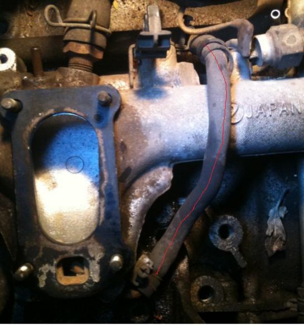

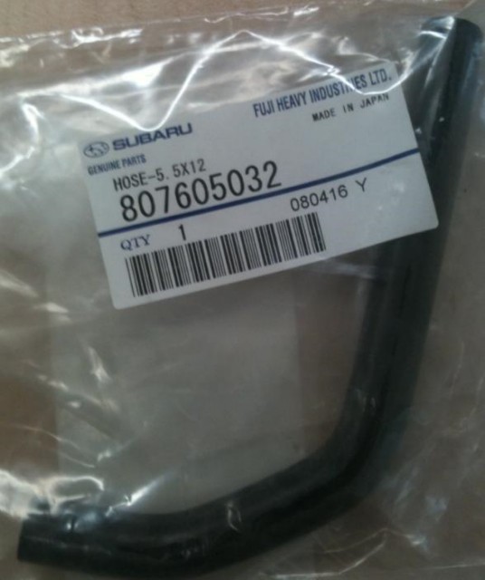

While I had the carburettor off I replaced the two water hoses that are under everything between the Inlet Manifold and the block. Could have probably used any old hose but as I want to keep this girl alive I got genuine ones.
Pics and part numbers below for reference.
Drivers side 807605032 $17.52
Passenger side 807606172 $22.68
