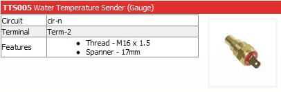

EA82 Water Temperature Sender Thread Size
I too am looking at this setup for my EA82 water temp gauge. Id like to use the original sender hole but looked at the top radiator sender adaptor too.Tweety wrote:...However this unit has two wires coming from its sender. eg it is a unique one to that unit and is smaller in diameter than the Subie temp sender. If it was compatible I'd screw it in there.
Doing a little searching for a adaptor for the stock location it looks like the thread is M16 1.5 pitch. My sender is a 1/8" NPT. Doing a search on that info doesn't return much so I was wondering if there is a name for the M16 1.5. i.e. some generic name that references that size thread. Have not found the answer yet.
There are a few eBay adaptors that appear to be in the UK, but $$$ and time i'd much rather something closer to home.
Below is a pc of the sender for the EA82 temp sender off the Tridon website. Note the EA81 and EA82 are listed as the same part.
EDIT: Update on this one, found a site that mentioned Deamontweaks in the UK but $27 in postage alone....then found a reference to Bursons, 2 min call and I have one on order under $10. See if it fits when I pick it up Thursday night. Happy to order anyone else one if needed/cant source locally etc.
- EA81-EA82 Water Temperature Sender.jpg (9.54 KiB) Viewed 7017 times
