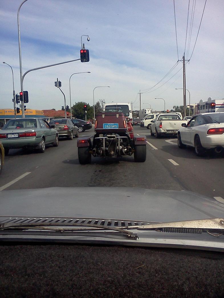

Saw this today and thought of you Tweety :) Stopped in front of me at lights, apologies for the poor phone quality pic. Looks like the same body as yours, if you can't see the blue plate says "2OLDFARTS" :o Wasn't the real plate though I don't think and it had NT written on it. Real SA plate is tiny and down below (blacked out)
Tweety
Posts: 1253
Post by Tweety » Fri Mar 30, 2012 8:07 pm
That's a Bon trike Sliverbullet. Bon trikes were pioneers in the VW trike world around 15 years ago. Good trike though. Panther and Oz trikes kind of superseded them.
