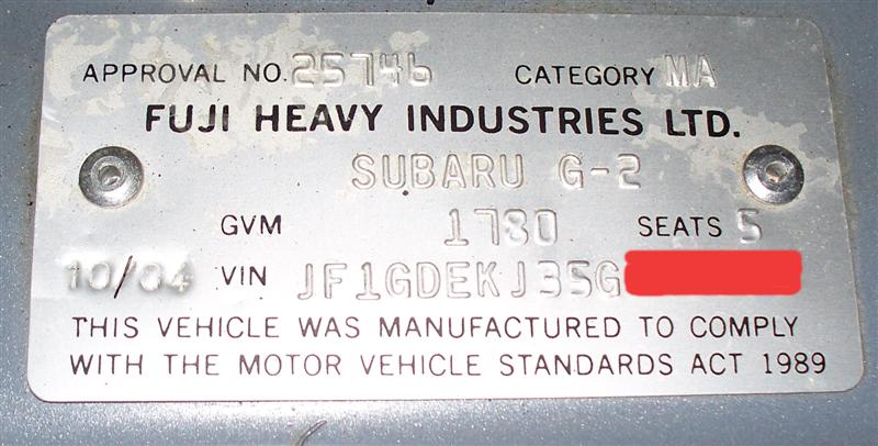

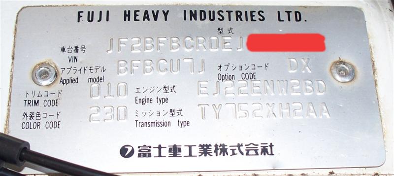

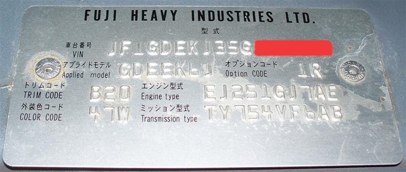

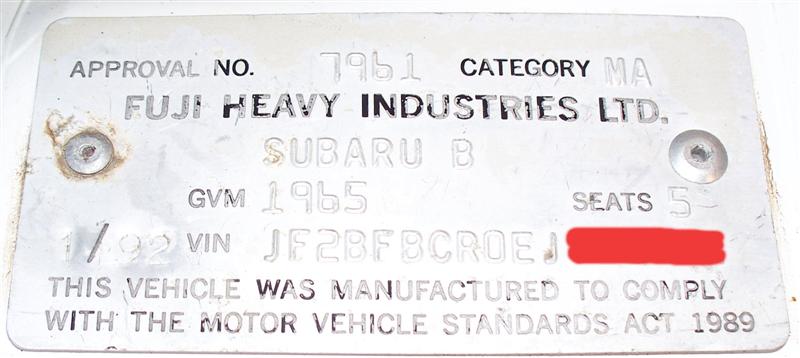

FROG, So does that make it a BC model? This is what I am trying to find out.
This is what I have on my current cars:
Liberty:
[ATTACH]949[/ATTACH]
[ATTACH]950[/ATTACH]
Impreza:
[ATTACH]951[/ATTACH]
[ATTACH]952[/ATTACH]
Liberty:
Impreza:

SUBYDAZZ
- FROG
- Posts: 1409
first plate is BFBCU7J
so yes bc
thats using the whole vin you gave me yesterday .... fast then pops up the model code...
cant do the rest without whole vin number
so yes bc

thats correctSUBYDAZZ wrote:Anyone, beause clearly a *GC8* just means any old 2L Impreza,
- FROG
- Posts: 1409
imprezas are gd's
on the last vin plate pic it has applied model = gdeek6j
