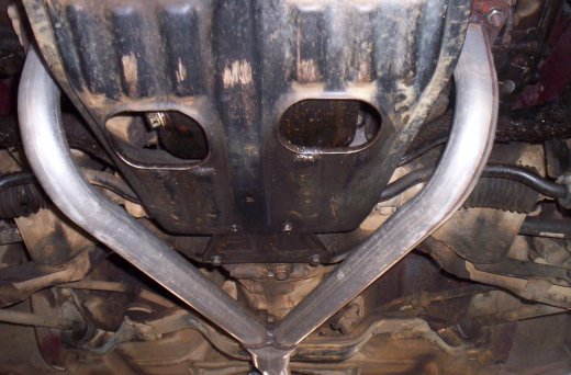

Yeah i felt creative last year and made some extractors for my L
I got the plans off an aeroplane site,.. they are designed so that the entire contents of one cyclinder fill one exhaust pipe. So i made it so the contents of 2 cylinders (0.9lt) filled that pipe and made the two 0.9 lt pipes merge in a Y shape. They actually ended up being very similar sizes to the stock headers. (except they were equal length) [PIC attached]
They did very little for power (removing the cat made the biggest power increase but i dont suggest you do that)
The biggest difference was the change in noise, it lost the boxer rumble and didnt sound much like a normal 4 cyl either. More like a race car. (with lost of backfire)
I didnt leave them on for long, i went back to stock headers with 2.25 from cat back and a sports muffer,.. you wont get much better than that.
