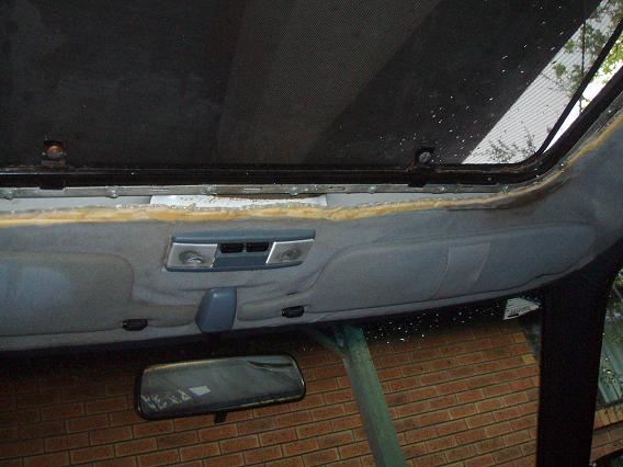

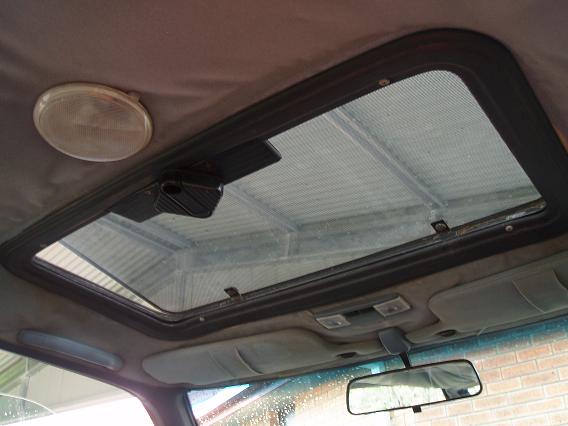

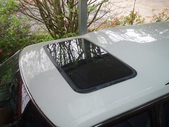

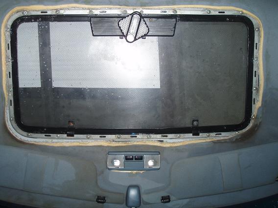

Got some sunroov pics. So its 100% an aftermarket deal, without drainage holes! hence now that the seals are buggered i get 1/2 a cup of water on my lap every time i turn left when it rains!!! As soon as i took the plastic cover thing off it all became clear. Note the rediculous water damage... Infact all the roof lining is shitty and has come un-stuck from the foamy stuff on the roof. Might look into that when holidays come...
Im thinking either get the seals re done (any advice welcome) or go hunting a new one. Thought id drop a pic of muh beast in there too...

The seal that is around the glass ISN'T for keeping water out. There will be a tray under the hoodlining that catches the water that gets past that seal, then drains it out, there should be a drain in each corner, not easy to get too, but plenty prettier than a silion bog mess.
