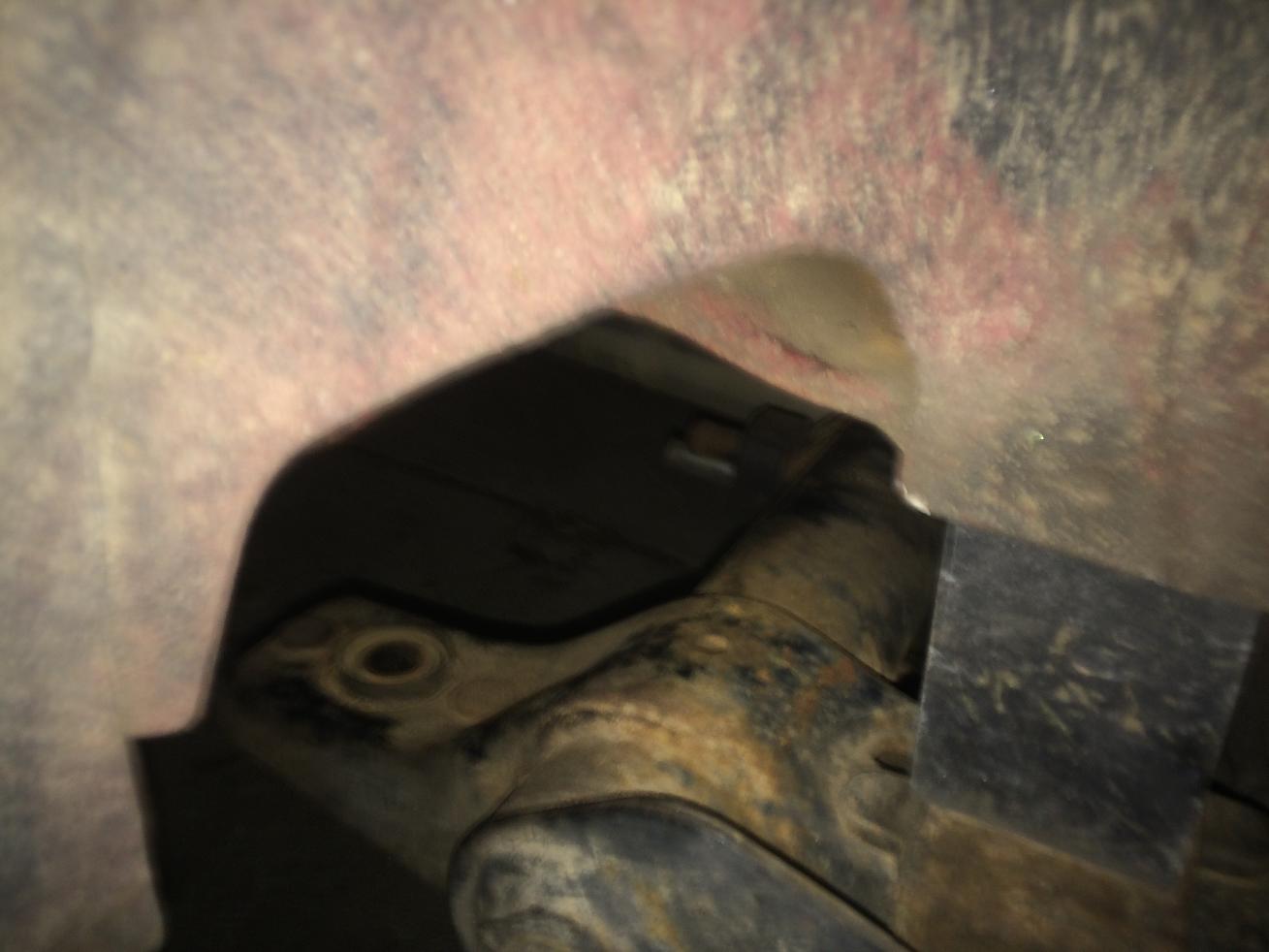

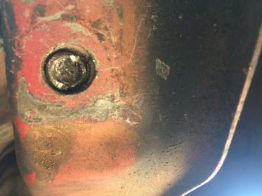

I have a 2" lift on my Brumby I've just bought and I've found that one of the rear passenger side 2"lift block is missing. I have the block and I've been to a fastener to got the bolt required. However, it looks as if the previous owner has already had a crack at trying to get the old snapped bolt out of the thread that's apart of the body as there's a snapped drill bit in it. I can't get this puppy out either so I'm hoping that someone may have an idea to get this old bolt out or maybe even if I start doing some welding and maybe make something else up. Also how to I get these rubber bump stops out near rear suspension. Still trying to figure out posting pictures so hopefully I can show the sitcho of what's going down. Thanks in advance for any input!

Where in the body is the snapped bolt?
can you get to the encapsulated nut from the top?
If that is possible then you could remove the nut and damaged bolt and mig a new one in
You could mig a stud in place where the broken bolt is and then use a nut to bolt the kit up to the stud.

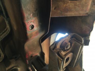

so this is where the block should be in place on the cross member-
[ATTACH]4648[/ATTACH]
Just behind rear tire wheel arch. You can see the other block to the right

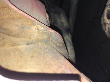

And this is the access to where the bolt goes into-
[ATTACH]4649[/ATTACH]
Not sure why but my photos are coming out sideways from my library but if you tilt your head the right way you can see it's completely sealed. Once I rectify this problem, should I strengthen this rig by welding steel between the two blocks?
