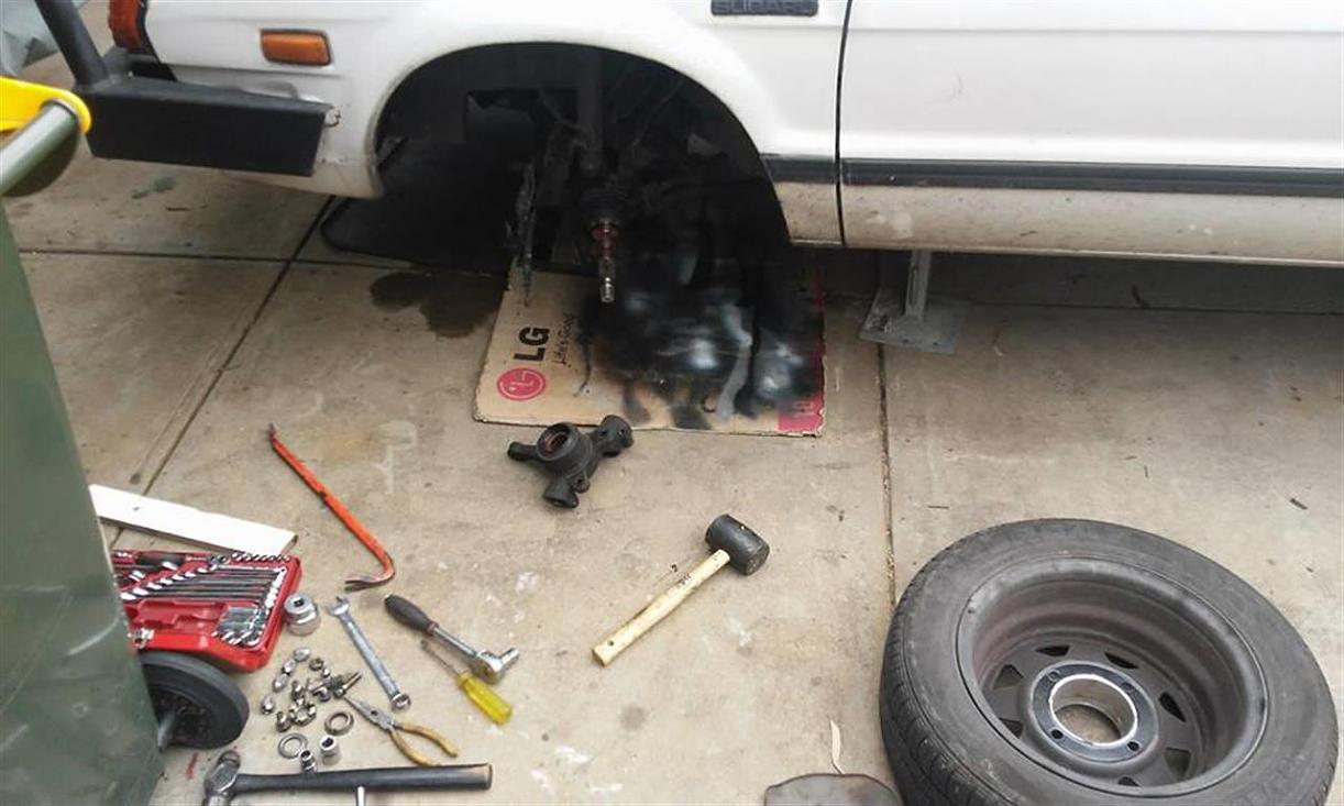

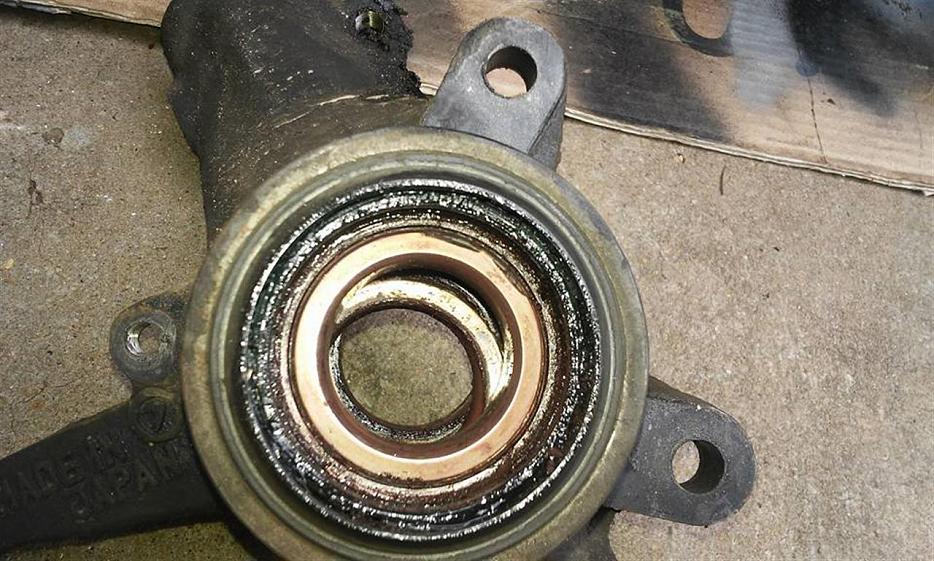

Following a painful week of wheel noise and chasing the wrong component thinking it was the problem today I stripped the drivers side hub down to check the bearings. Should mention to start with the bearings in this hub were installed not much more than a year ago if that and NOT BY ME! Professional service center did it as I didn't have the time back then, and no press.
I pulled the knuckle off the car and straight away knew something was wrong as there was a chip missing from the inner race of the outside bearing. Wiping the grease away I noticed the inner race of that bearing was full of hairline cracks, and the plastic sealing ring was no longer seated properly. Also the drive shaft itself where it meets the knuckle was covered in burnt/overheated grease. I went off to the press to try and press the offending articles out. Second thing I noticed; the spacer inbetween the bearings was jammed in place :confused: Managed to bash it to one side and put some pressure on the bearing, this is what fell out the bottom:
Notice the outer race still inside the hub!
So this is why it was making so much noise! Such destruction I have never witnessed before! So bad even the balls themselves were pitted and cracked. The inner race (or the pieces of it) had heat discoloration.
Notice the sealing rings all melted around the edges.
Strangely enough the other bearing race was mostly okay, still turned smoothly although I could see one of the seals on that one was starting to go as well.
Moral of the story; I will never again buy a sealed type wheel bearing kit. Or if there's no option, I will pull the seals out and pack them myself. It's obvious what has happened here; either the seals weren't up to the job or someone damaged them on install but the grease has leaked out (or maybe there wasn't enough to begin with) and overheated everything. Explaining the burnt grease everywhere and destroyed inner race.
I had a RH knuckle with new bearings and seals ready to go lying around from when I converted the blue wagon to L series everything, so I put that in to finish the job quickly. These were sealed type bearings as well and as they were already installed I couldn't pull the seals out. But I'm not too bothered, if this side fails again in the next 12 months it will confirm my theory that sealed wheel bearings are useless. New hub in place, took it for a drive and now she rides silent and smooth again.
Also, camera tripods are useful for many things ;)

Post by Silverbullet » Sat Sep 10, 2016 4:46 pm
Well here I am pretty much a year later to the day since I last had wheel bearing problems on the ute - and what do I find myself doing?
Every year around this time, for the last 3 years, I've had some problem with the ute with front wheel bearings or drive shafts (my drive shafts this year are stuffed too) You'll notice this is a different side to last years (and the reason this thread was started) And, once again, the sealed front wheel bearings have let me down. I know for a fact the sealed bearings I replaced today were put in properly - this hub/knuckle was originally on my wagon resto project before I changed to all L series stuff.
Started out as a little *squik* *squik* *squik* that came and went at random times and I could never track down, thought it was something rubbing. Last week I had to travel 60+k's every day for training and towards the end of one leg the *squik* got really bad and was accompanied by a clunk clunk as well. Pulled over, checked everything, couldn't find issue.
Today I pulled the hub down to investigate and found the grease from inside the sealed bearings had leaked out, bearings were cooked (inner and outer) and chunks missing from the inner race of the outer bearing (see photo) Luckily I had a CBC bearing and seal kit in the shed still from last years episode - no hesitation in throwing the sealed bearings in the bin and replacing with open type properly greased with good grease. Took note this time, the sealed bearings had C3 etched on the outer race, as do the new ones.
Must have been the longer trip than normal gave the bearings time to really heat up, there was cooked grease stuck to the drive shaft/axle stub and the bearing spacer which lives in the middle. Also noted CV grease has splattered around from the inner CV so probably the heat has done some other damage. Luckily I jumped on this straight away and didn't give the bearing time to break into pieces as in last year.
