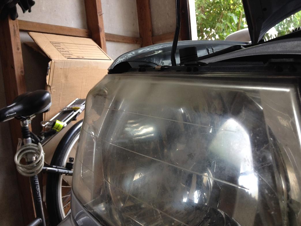

So the headlights on the new SG Forester looked average. Hazing, oxidation and plenty of light scuffs and scratches.
I decided to try to get them looking nice again.
A before shot, giving an example of the condition I was dealing with.
- Condition.jpg (96.51 KiB) Viewed 4624 times

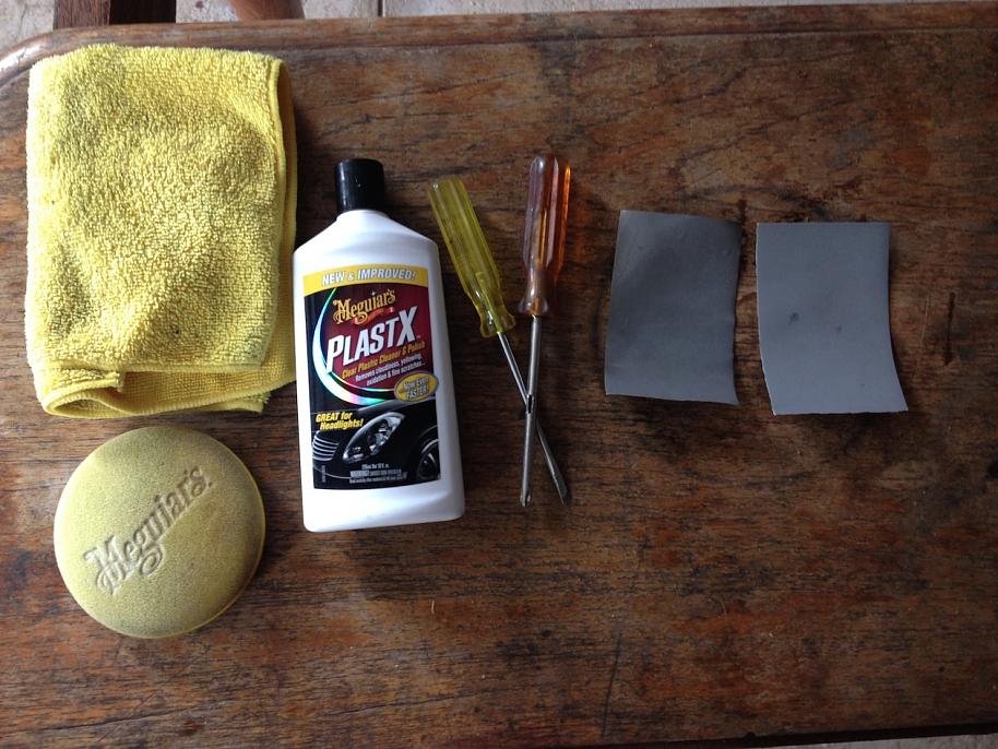

This is what I used
These are the products that I used.
No affiliation with the products shown here but the polish was $20, and the sandpaper was 2000 grit and usually $1-$2 at any good paint or auto store.
If your lenses were really bad you could start with a 1000 or even more coarse grades.

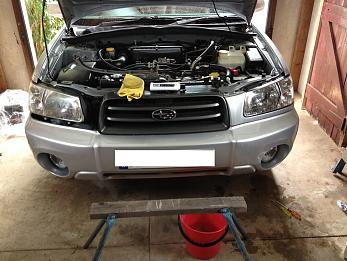

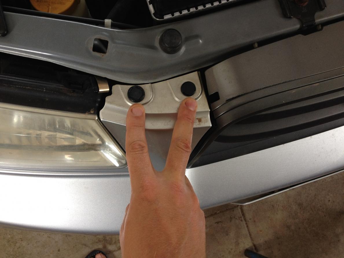

Next
I then removed the trim, by pulling out the two fixing screws and sliding out the whole plastic panel, first by tilting it out then pushing towards the outside of the car.
- Trim clips.jpg (94.55 KiB) Viewed 4622 times

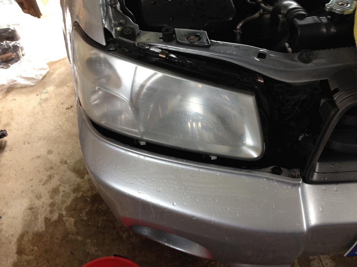

Sanding
Then I hit it with the sandpaper, using a small amount of detergent in a clean bucket full of water until I had a nice milky looking lens.
At this stage it is easy to panic thinking you have f-t-ucked it all up, but persist and READ ON!
- Sanded back.jpg (92.34 KiB) Viewed 4623 times

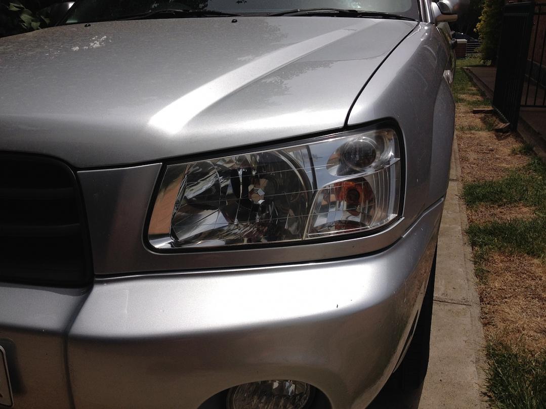

Then I hit it up with the plastic polish, which is basically an emulsion of aluminium oxide and waxes in suspension I think. Followed instructions and easy to do.
Sorry I didn't get a better shot of the finished product, but both sides are now much better.
Here is a picture of the other side as a finished lens, as well as one done with the other being polished. It was in equally poor condition to start with.
The whole process took me an hour from parking the car to having a cup of tea. Cheap, easy, no mess and results are a very clean looking front end.
If I did it again I might go for a second sanding stage at 3000 or even finer, as there are still some sanding swirls visible, but not from more than 2 feet away.
I'm wondering if a bit of clear coat might bring up the shine and protect them a bit- thoughts?
