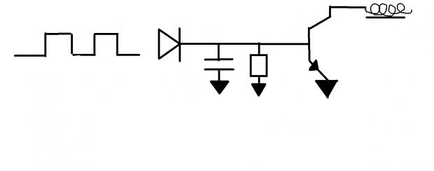

If your feeling like doing it yourself Tweety something like this should work.
Just have to play with the resistor and cap values to get the desired duration of fuel pumping after the engine stops. I wouldnt try using it on points though.

Doug- what are those curly bits and triangles?????

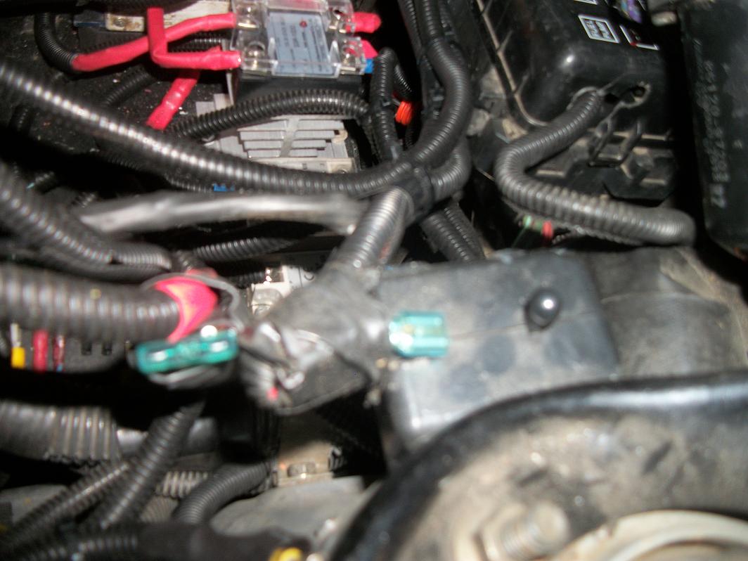

switch
Post by poprock1 » Fri Aug 29, 2014 7:54 pm
as in murky pic, small knob is reset switch. 3 leads, power or earth in out, or power cutout. Mine breaks earth fron contactor.

Sorry Tweety. Circuit is an inline diode, then a pull down resistor of some high value and a cap to ground of some random value depending on the resistor value, the output of which goes to the base of a transistor, which pulls in your fuel relay. The pulses from the disty charge up the capacitor thru the diode, but the capasitor cannot discharge back to the distributor because the diode blocks the current. So then the capasitor slowly discharges thru the resistor. As long as the cap stays charged between pulses from the disty it will hold the fuel relay on. It may need an inline resistor to the base of the tranny as well, depends on what parts are used and the current flow.
Doug
