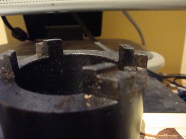

Post by steptoe » Mon Jun 30, 2014 6:45 pm
I got one through our buying agent in the the US, so no credit for making it.
OD is 62mm, wall thickness is ~9mm
about 32.5mm max between outside of a pair of those teeth
each tooth must be 1/4" thick (coz I forgot to buy the battery for the verniers today :( 6.05mm ?)
and the teeth aren't just flat on top, it's like they were 8.2mm tall but inner 4.0mm remains while about 5.0mm, so is stepped from 8.2mm to 5mm - if you get what I mean without a camera and pair of gloves
Total tool height is 61mm and with a square hole for 1/2" drive
weighs 700grams !
no idea why the step

Jonno I can't quite picture it :???: Why would the teeth need to be stepped? Can't remember the dimensions I used off the top of my head, I can get a CAD drawing/dxf for the business end if anyone is interested in making one themselves.

Silverbullet wrote:Jonno I can't quite picture it :???: Why would the teeth need to be stepped?
Probably so that the thread inside the hub isn't damaged if the nut goes in that far so that the tool fouls on it.
SB - that's a much more professional looking tool than mine - I've made mine so that I need to remove the axle first as the tool goes into the hub...
Post by Silverbullet » Thu Jul 03, 2014 12:43 am
Since Jonno added that photo in an old post the thread didn't update, now I see why it is stepped, to guide the teeth using the ID of the nut. Much more economical on metal than my idea of using the stub axle as a guide. Well I wasn't far off anyway! I can see the boss man now, if I walked in with an idea like this to make these. Sadly it's the sort of place where they say no, and that's the end of it....unless I come in early or stay late and I already get up early enough and get home late enough...now I'm rambling :rolleyes:
