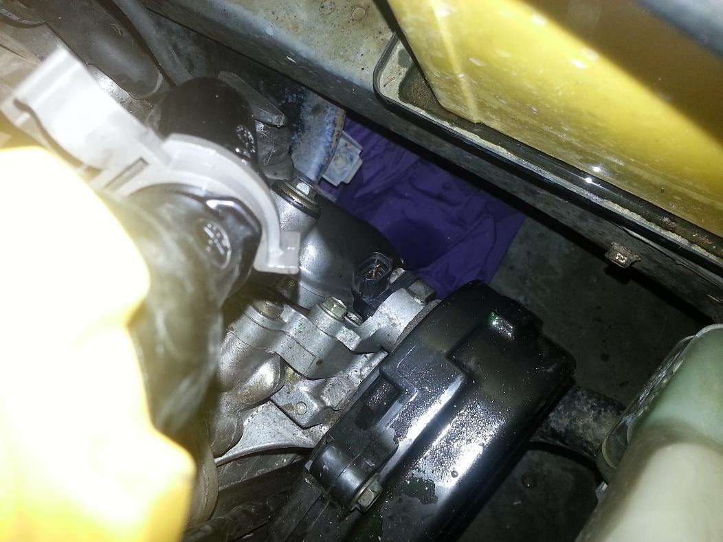

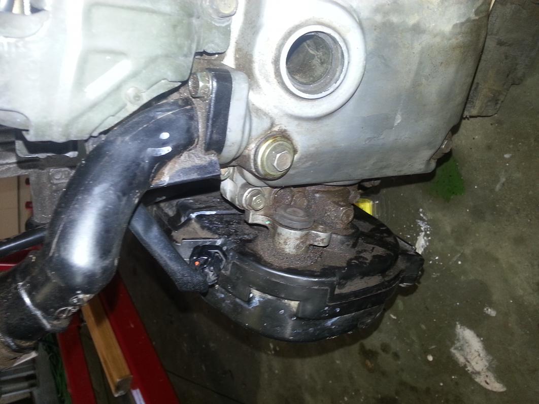

Can you post a detailed photo of the cam sensor on the 2.5 and a photo of where it isnt on the 2.0?

gday mate hey thanks for your help. both engines have ej20 on the block, which i assume means 2.0 litre[ATTACH]4413[/ATTACH]
[ATTACH]4414[/ATTACH]
top pic 99 with rubber bung
bottom 05 sensor with nowhere to connect.
didnt see the car but am told was 05 forester will check on that
05 ej20.jpg (101.03 KiB) Viewed 6060 times
99 ej20.jpg (96.88 KiB) Viewed 6061 times

05 is out of imprezza
