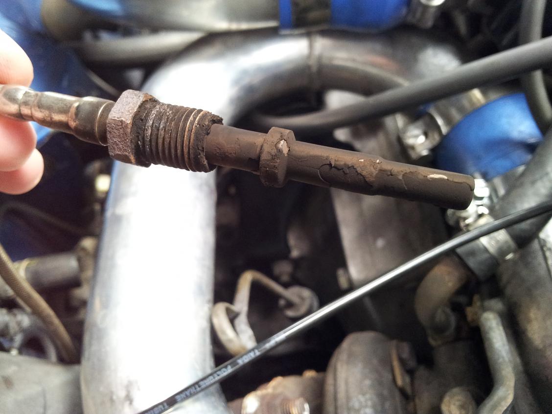

I have found a "neutral position switch" in the car manual, connected to the "ECM" however this is not one of the fault codes. My car shows me 2 CEL codes and my mechanic used his very expensive fault code reader to pull out 7. The oxygen sensor is one of them. I pulled it out and took a photo. It looks pretty bad. I can't find a part number on it though, the only thing I could find was "48k". The screw part is very loose and I can move it very easily which may be the reason why I can smell A LOT of fuel/exhaust fumes in the engine bay when the engine is on. I think the exhaust is leaking out of this sensor.

That doesn't look like an O2 sensor more like the thermocouple RSR555 was talking about.

Yeah, it was in the large pipe, leading under the car, right after the turbo. After looking at pictures of thermocouples, it looks much more like them than an oxygen sensor. This sensor has a 2-pin connector, if that helps. Is it possible this sensor is in the wrong place?

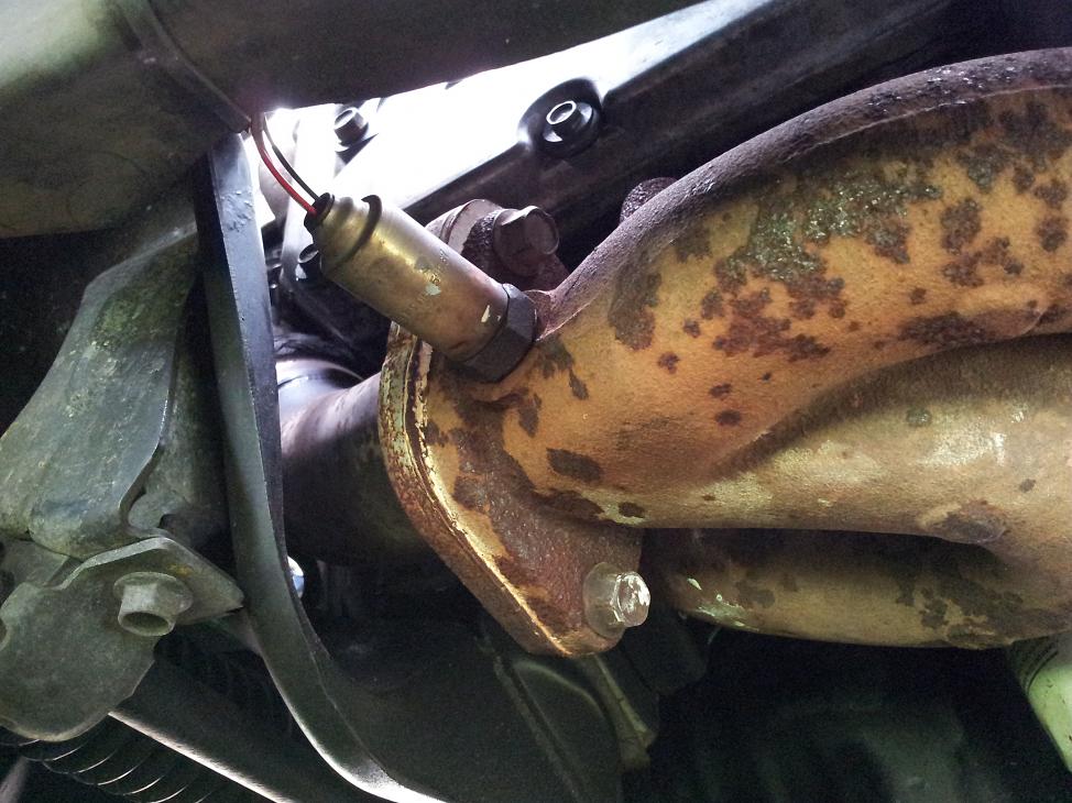

Okay I think I found it. This one has a 3-pin connector. I wont be able to find the one near the catalytic converter until I jack the car up.

Ok so the thermocouple is where it should be but stuffed or if you are lucky just in need of a good clean.
The O2 sensor looks to be the original from 1993, which means while it may still be sending the ECU a signal it woudn't be very accurate.
You may or may not have a second O2 sensor.

Looking at that first picture, I'm thinking that this is a thermocouple for an aftermarket exhaust temp gauge. The factory one has only one wire and is at the bottom of the cat in the dump pipe (just before the bend that goes under the car). If your O2 sensor is in the crossover to up pipe, then your engine is an early WRX import engine. In the Au delivered WRX the O2 sensor (3 wire model) is just after the turbo in the dump pipe where it bends down to the cat. The diagram picture you have is of a later model.
