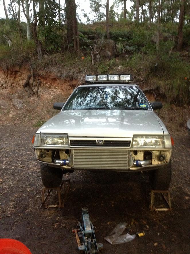

Post by Mitchhsj » Sat Aug 24, 2013 8:39 pm
A pic:D

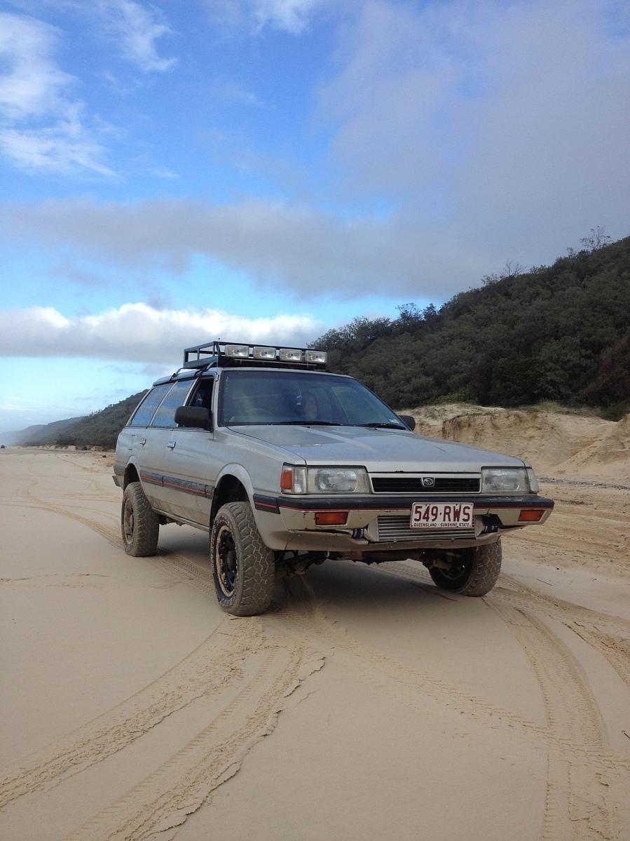

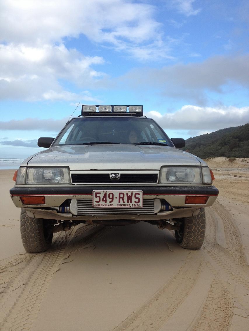

Post by Mitchhsj » Sat Aug 24, 2013 8:40 pm
Another

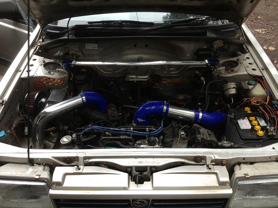

Post by Mitchhsj » Sat Aug 24, 2013 8:42 pm
Under bonnet
Post by steptoe » Sun Aug 25, 2013 8:24 am
FMIC install looks tidy. The throttle body top is usually not a snug fit with standard imperial silcone bits ...what size did you use and hows it fit nice and tight ? Sneaky snip and good clamp? What boost pressure on the cool sode of the IC ?
Post by NachaLuva » Sun Aug 25, 2013 8:57 am
Very nice install :cool: Looks like a full body lift kit?

Post by Mitchhsj » Mon Aug 26, 2013 7:13 pm
Thanks guys, the throttle body is 2.25 inch and my piping is 2.5 so a good clamp its fine. It's running 9 pound happy as.. I have I
Only ever had the piping pop off once and that was up the beach right in the cutting, so I had so stop:( witch sucked because I love flying passed all the bogged 4x4s and blowing them all away.. And it popped off the turbo because its a joiner over a joiner but hasn't botched me since.. Yea it's a 3inch body lift with another 1.5 in springs so 4.5 all up... Spent the day on the brumby wiring soo close just haven't got spark yet hard blending 1.5 looms to make one efi one

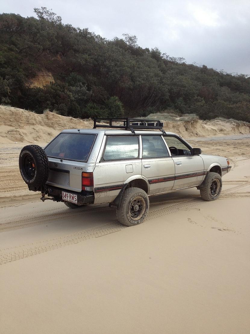

Post by Mitchhsj » Mon Aug 26, 2013 7:18 pm
Rear view
