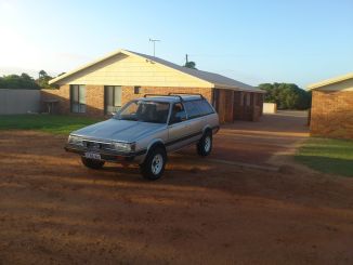

Heya all,
Stuck with a dilemma here, going to spend some cash on my 93 L Series, it is due for a complete Timing kit and I was going to replace the Oil Pump and Water Pump at the same time, the Km's are 245,000 and have a Weber installed along with a new top to toe custom Exhaust system, I also need to get my steering rack replaced, so there are a few dollars to be spent here.
The big question is should I just go EJ or have all this other work done on the EA82, I must say that I like the simplicity of an EA82 that if some thing goes wrong it is generally easy enough to fix the problem if stuck in a remote situation.
Any suggestions or Pros and Cons would be appreciated.
WayneO.....................

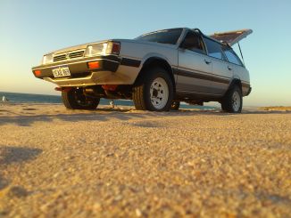

Forgot to mention
Forgot to mention, I drive this car daily and it is always on the Beach or up River and never has any problems with soft sand, only wanting the upgrades because it is somewhat sluggish on any sort of incline both off road and on road, eg maximum speed on the bitumen is 75 to 80kmh up hill with no gear in the car and the driver only.
Cheers WayneO..................
