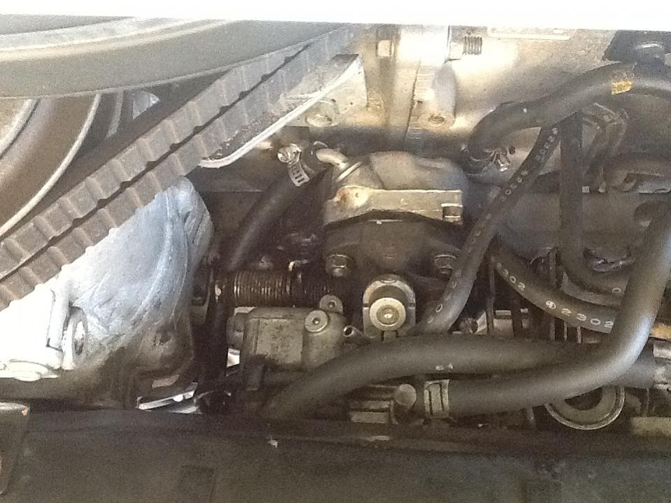

Hi guys, looking for the air/fuel screw on the carb of my ea82 l series. Is it located just to the right of the idle screw in that circular piece of metal?
[ATTACH]3743[/ATTACH]
Do you have to drill this section out?
For some reason this photo insists on being upside down, sorry!
- image.jpg (104.78 KiB) Viewed 2217 times
Thanks guys, I have left it alone.
Steptoe, on a spare carby I have this has been drilled out and underneath is a tread and mixture screw installed. Not sure if it was there from factory though.
This morning I found a vac line that had been disconnected in my rumblings. Reconnected it and car is idling and running smooth again. Just goes to show...it's normally the simple solution hey.
