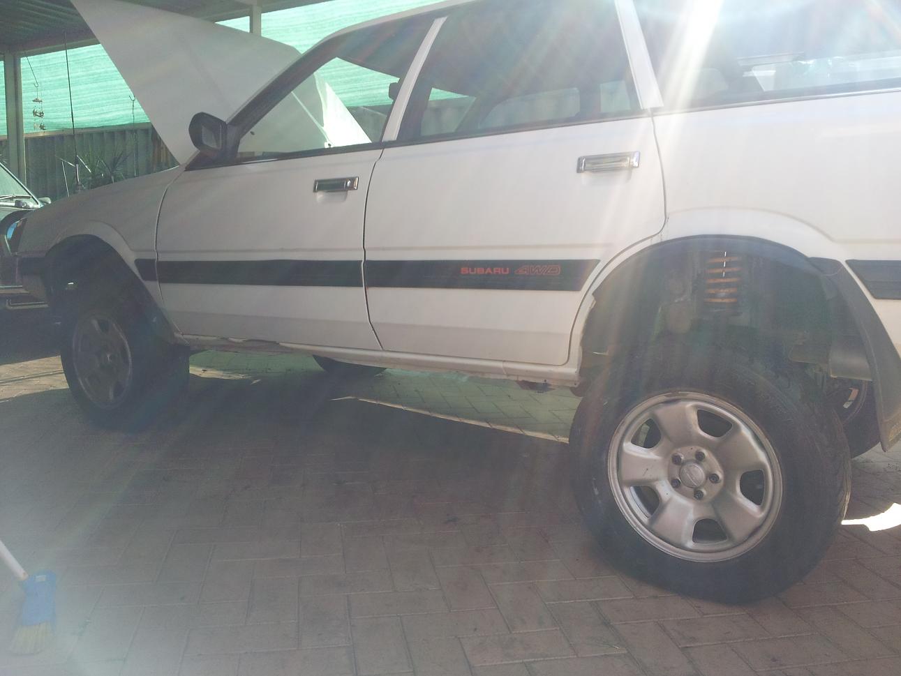

i was tolled about the mod not how to set it up.
so i give it a go i used a second on set of 180 sx rear struts $20:-)
an old set of l series rear struts that where stuffed
1 removed springs from struts
2 remove spring bases from l series struts and die grinded them out to just fit over the 180 struts
3 placed l series springs on and top mounts on (and it was hard to get springs on) eg maybe i should of cut spring
4 used the old l series bottom bush centres(sleves) in the bottom of the 180 strut
5 fitted to my wagon (with out the 2" lift bracket) and give me 3" suspension lift
6 did Drive ok but maybe needs to some adjustment
- 20120914_143214.jpg (92.38 KiB) Viewed 2814 times
Proud to say this is the mod a came up with:) still going strong after about 8 offroad trips...
