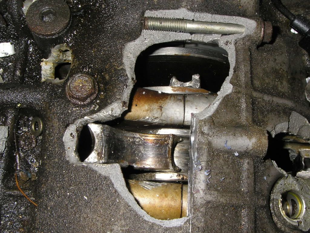

i took some pics of the air intake, were the oil is. the heads look finds from what i have looked.Gannon wrote:Can you take a photo of your engine?

- littlewhiteute
- Posts: 623
- Location: Brisbane
- thunder039
- Posts: 998
- Location: victoria AUS
i think it may also be fatal, but i still have hopelittlewhiteute wrote:Sorry to say, but that looks terminal.
I'd say you have a cracked piston crown.
if it is terminal what could cause something like this?
