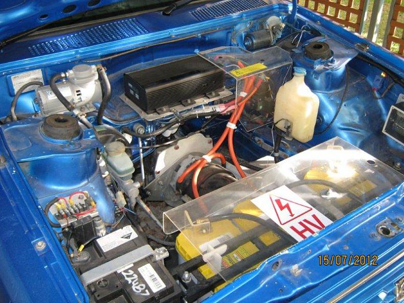

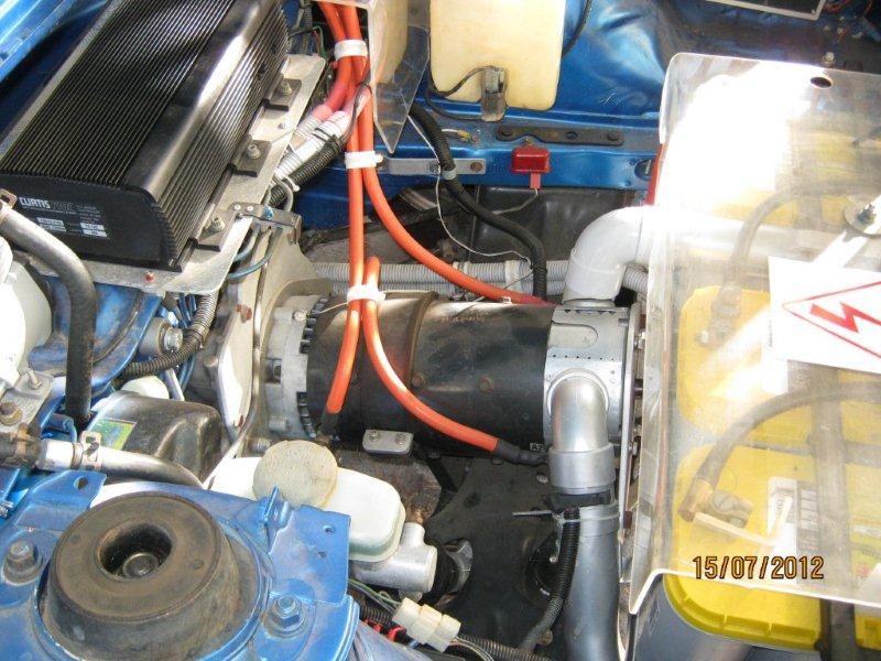

some photos
Posts: 2952
Post by Silverbullet » Mon Jul 16, 2012 8:58 pm
Nice paint job! Looks like a very neat build. Only 10 battery packs, did he tell you what the range was like?
Post by Alex » Mon Jul 16, 2012 9:30 pm
Each one of them batteries are worth about $350 ballsy conversion but awesome!

i like the energy rating sticker
