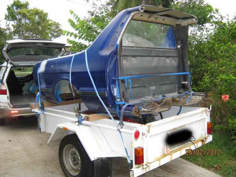

Anyone choped a Brumby in half and made a trailer from the back half.
I have an Idea and half a brumby but would like to see if anyone else has done it.

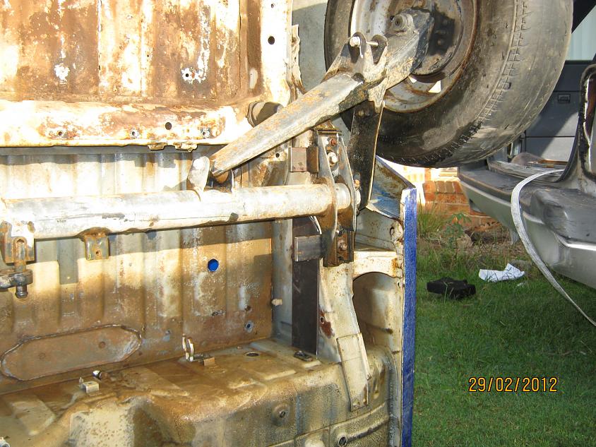

I Have this A coup rear suspension and some bits n pieces I have acumulated.
It has some rust so I will have to blast it in places.

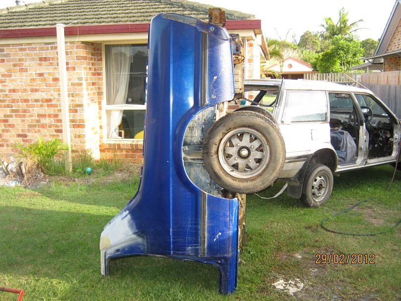

I have an idea, just need someone to help me get the shell off the trailer, but I have to roll an L series onto its roof to stip some parts off before I start on the trailer.

Steptoe I just checked the Brumby swing arm has 25-30mm bump stop blocks on th arms where the coup doesen't have any blocks. At a guess that will give and extra 50-60mm travel at the axle before the swing arm hits the rubber. I may have to weld a 6mm flat plate on the swing arm though to the rubber stopper hits a flat surface.

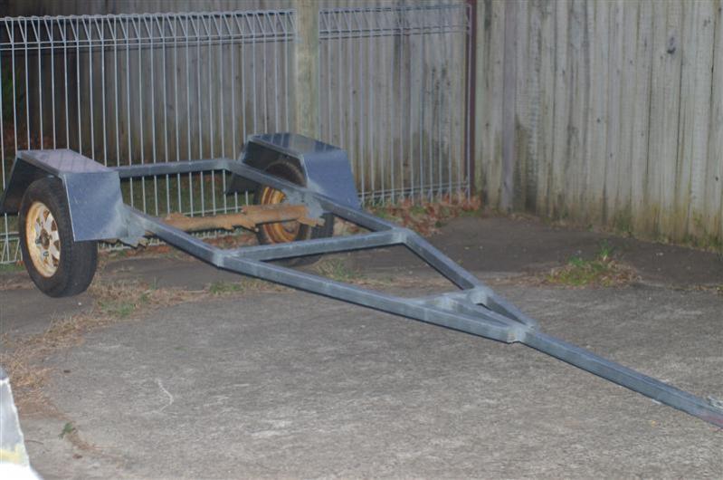

Some playing around.
Fitted up the torsion bar and put some wheels on so I can move it aroud the back yard.
Have dry fitted some plates to weld the draw bar to, still playing with Ideas.

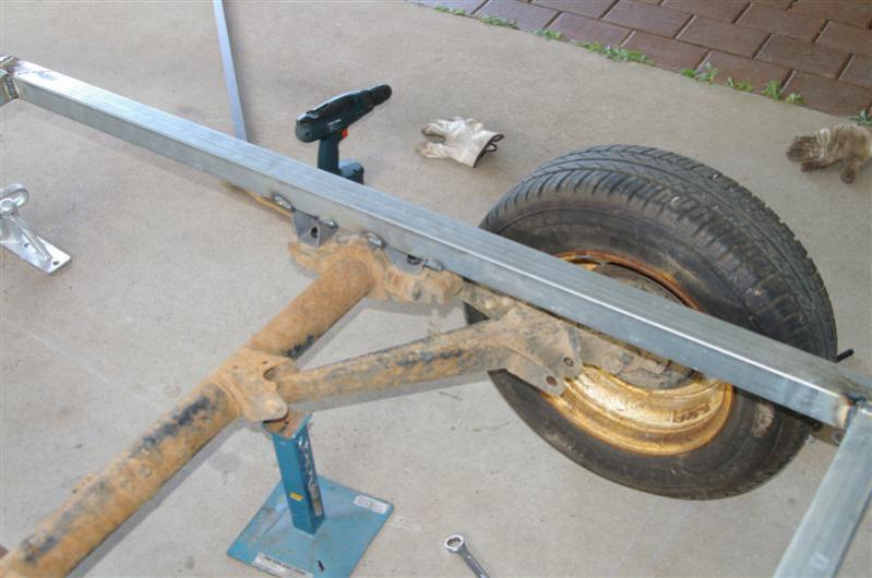

Food for thought, ex member 'Mechawagon' or Ben, made a boat trailer using the 2wd rear end from my MY sedan.
- IMGP0057 (Medium).jpg (59.12 KiB) Viewed 4239 times
- IMGP0024 (Medium).jpg (52.79 KiB) Viewed 4239 times
alang. That is a great Idea.
Thunder. yep will do, Picking up some 50x75x3 RHS Gal today. Nah sorry no idea on what it will weigh as yet.
Gannon that is pretty neat, did he leave provisions for shockies. I like the A frame onto a single bar idea and will use it.
Nah just using the torsion bar, its only for a tinnie
