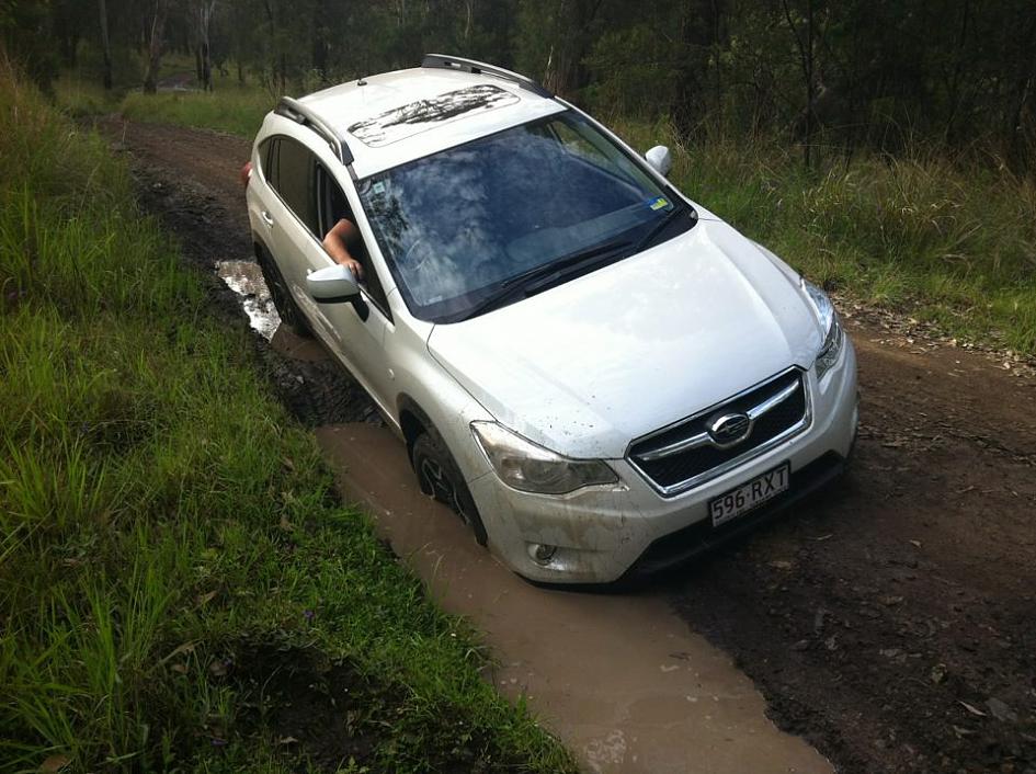

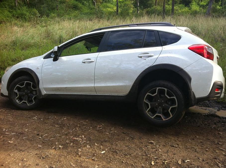

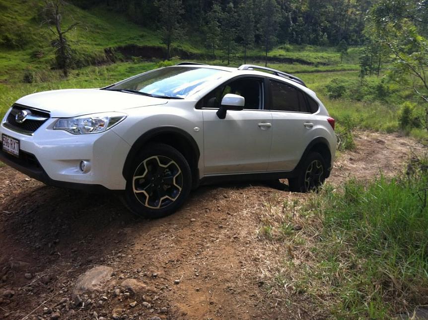

Post by Excelix » Mon Feb 13, 2012 9:07 am
Some pictures

Post by Excelix » Mon Feb 13, 2012 2:17 pm
Hope my above pictures worked? that was the softest areas this car was put through its paces specifically so I can see the design flaws, clearance was fantastic hardly any scraping what so ever, we tried to look for the fuse at the time but no luck? Any hints on what kind of fuse it would be that would be controlling the stability control? The hill start assist was also fantastic for hill climbs and I think it can survive without the low range for soft roading just need to disable the traction control.
Please note I never expected to be boulder climbing in this car, just have days of some 4wd tracks and be able to tow my ski onto the sand

Post by taza » Mon Feb 13, 2012 2:19 pm
Excelix wrote:Hope my above pictures worked? that was the softest areas this car was put through its paces specifically so I can see the design flaws, clearance was fantastic hardly any scraping what so ever, we tried to look for the fuse at the time but no luck? Any hints on what kind of fuse it would be that would be controlling the stability control? The hill start assist was also fantastic for hill climbs and I think it can survive without the low range for soft roading just need to disable the traction control.
In the back of your owners manual it will have all the fuses and what each one is. Try looking there :-D
I reckon for softroading the car should be fine :mrgreen:
Yes the pics worked.
