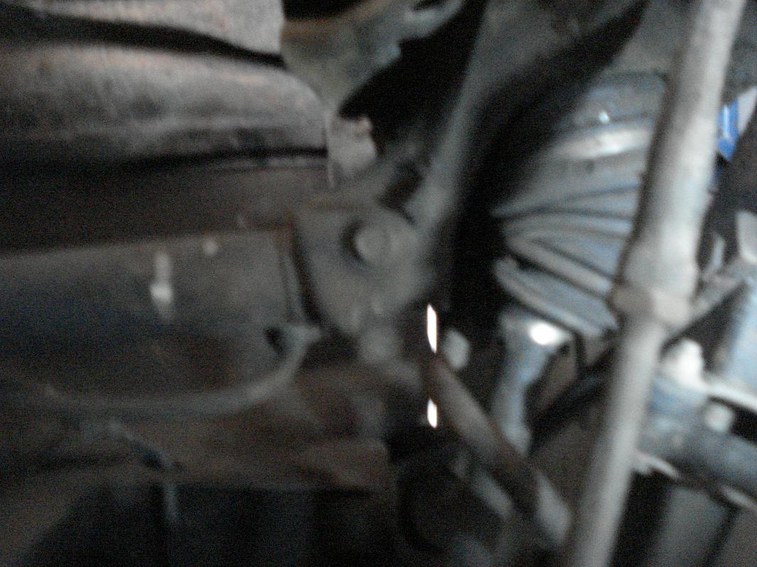

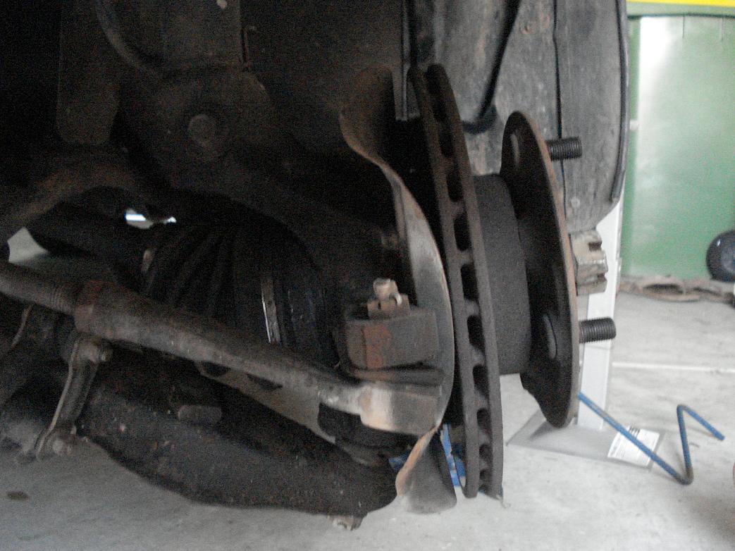

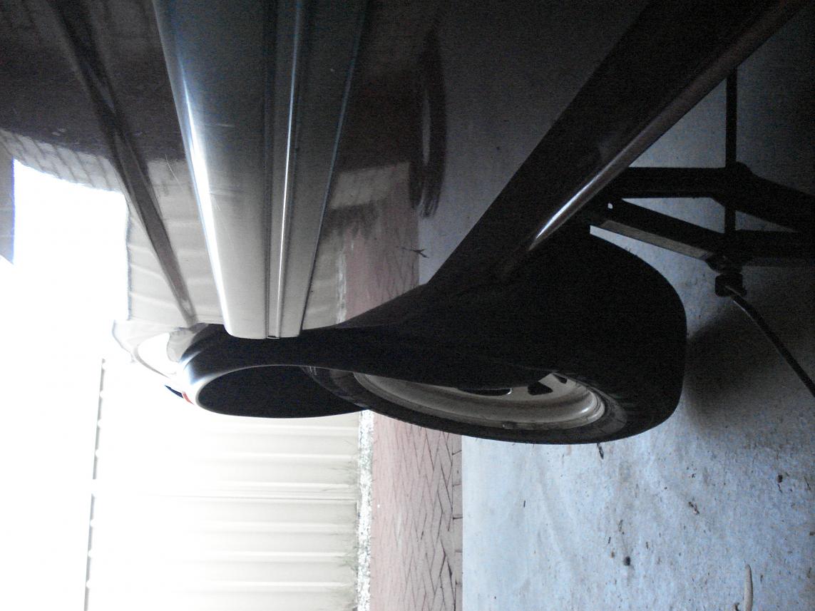

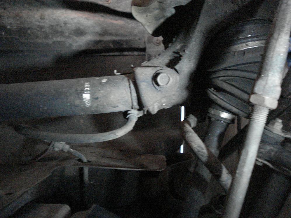

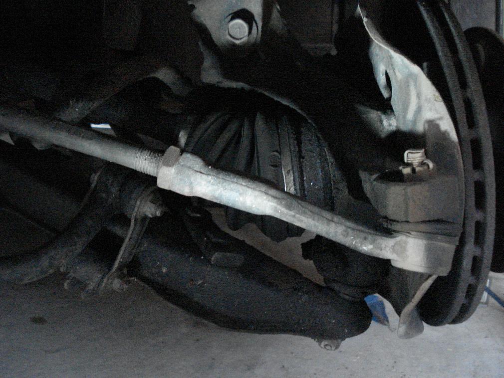

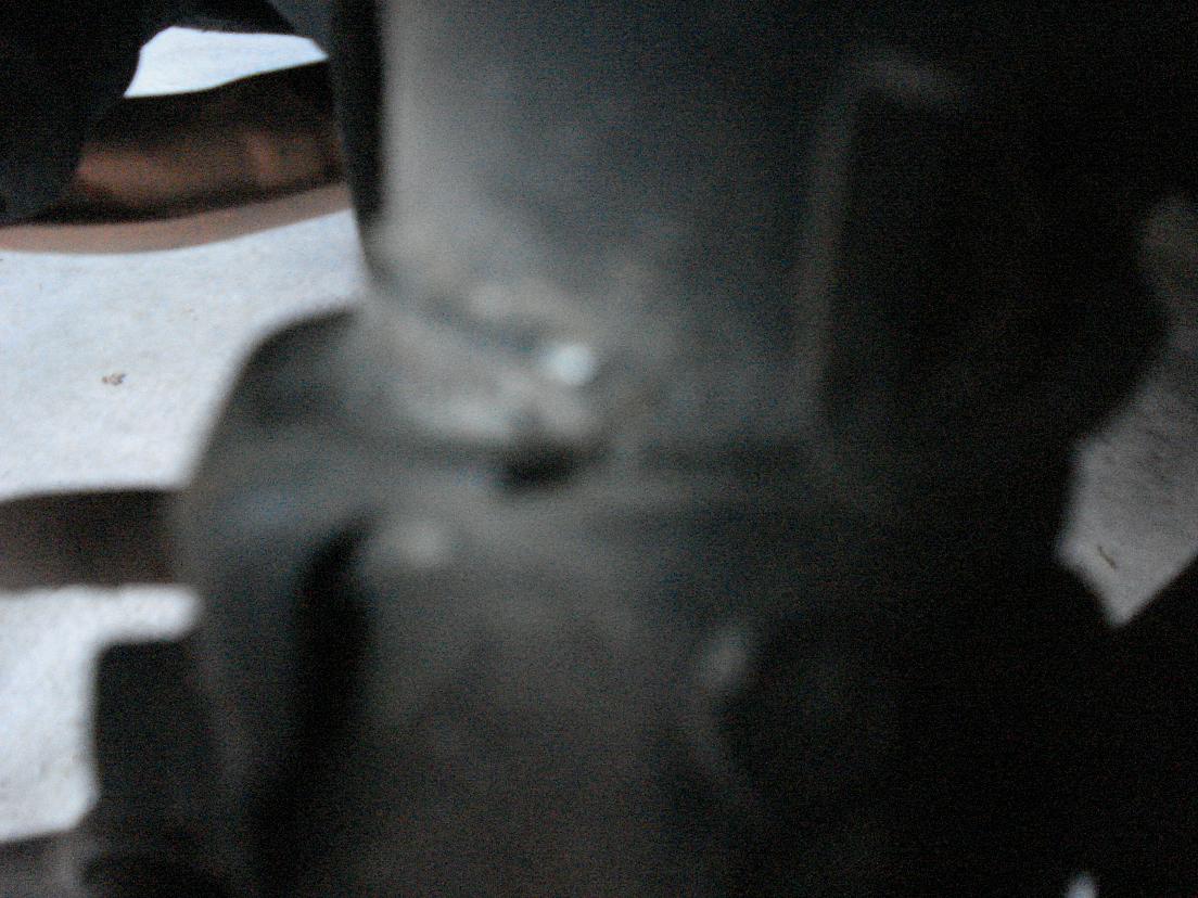

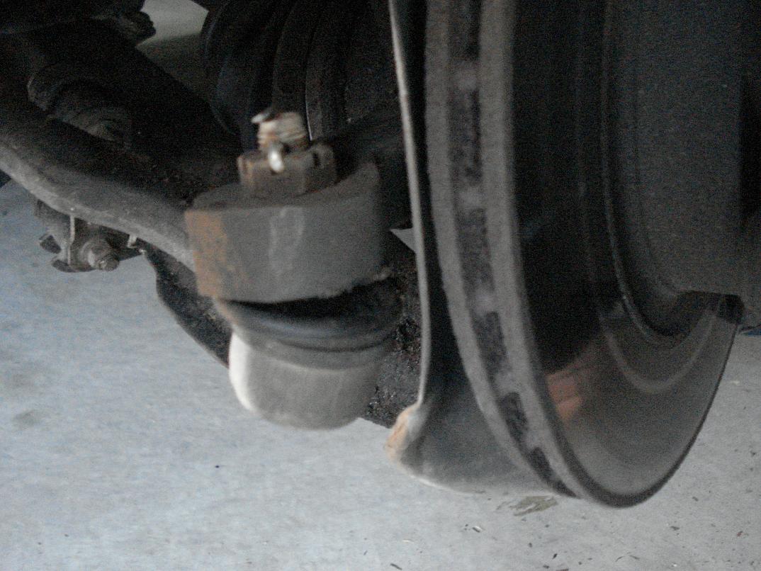

pictures:
[ATTACH]3164[/ATTACH]
[ATTACH]3165[/ATTACH]
[ATTACH]3166[/ATTACH]

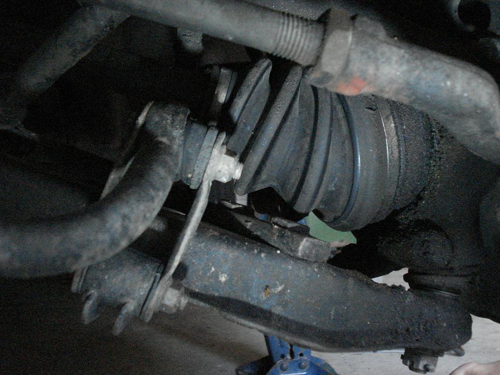

Post by 2nd Hand Yank » Fri Feb 10, 2012 4:19 pm
more pictures

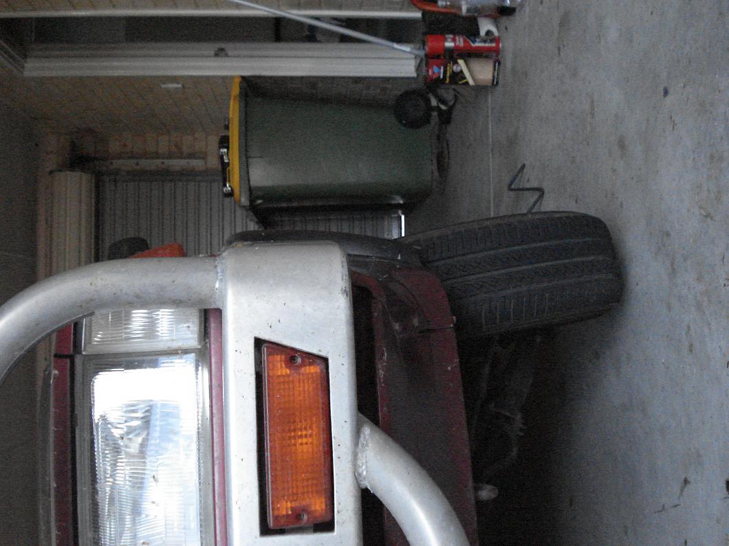

Post by 2nd Hand Yank » Fri Feb 10, 2012 4:21 pm
and another
Post by guyph_01 » Fri Feb 10, 2012 4:50 pm
Looks like a bent strut or hub to me, Steering ends are fine i think. They are ball joint and move anyway.
You might have to take the strut out to be sure.
Post by RSR 555 » Fri Feb 10, 2012 5:44 pm
Definately a bent strut. I would replace this.. I'm sure KPM (aka Guyph) would have one lying around. Maybe even fit for you. Then take the car for a wheel alignment and they'll let you know if anything else needs replacing.

Oh.. and as for the fender.. I can't see too much damage, so I'd leave it on.

Fender looks pushed in just before the door and he also wants to replace it as its full on rust with holes. KPM is happy to fit it for you but its a long drive to my place.

yeha looks like bent strut and maybe hub, id start there and see how you go!!

The strut will definitely be bent, If the wheel wobbles as it turns the hub will be bent but I doubt that the hub assembly (cast iron part that everything mounts to) is bent, that'd break before it bent.
The CV shaft should be good. Guard looks fine.

RSR 555 wrote:Oh.. and as for the fender.. I can't see too much damage, so I'd leave it on.
The door will only open 10-15 cm before rubbing on the fender.
That's why I thought I should replace it.
Unless... there's a way to pull it straight from the outside.
No access to hammer it back out from the inside. :???:
