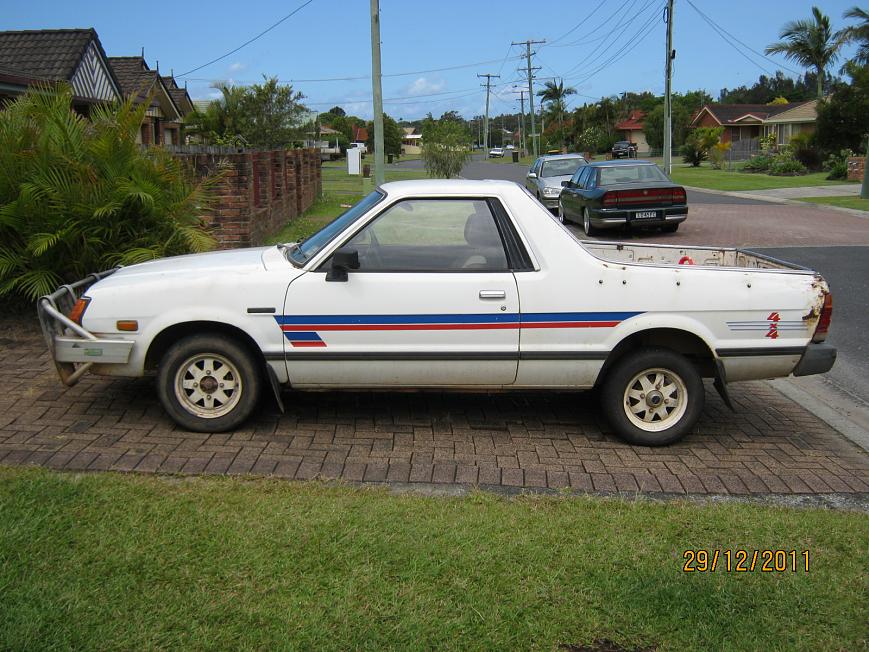

Bought this one for parts and farm ute on a mates farm.
Fixed the drive to the front today, thanks for the help fellas.
She has a water using issue which may be a blocked radaitor.
I will fix a few things raid a few parts and send her out to pasture, where she will get driven around the farm by my 3 and 6 year old kiddies with my help of course.
This one is not going to the wreckers or metal recyclers.
List to fix.
degrease engine
set ignition timing
Radaitor
oil change
flush the brake fluid
broken seat rail
Rear shockies are RS but that don't matter
Oh and put old tyres and rims on it.
Will blast and paint the rims on it at a later date.
then just raid her for parts

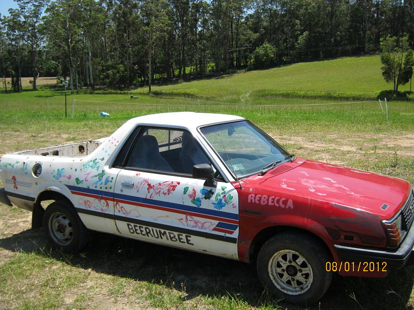

Put a good second hand radiator in it yesterday cause it was using water and suspected a blocked radaitor, from a Brum I wrecked a while ago. Went for quck spin up the Hwy and back @110kmh. Didn't seem to use any water so hopefully the problem is fixed.
She starts pinging @ 4K and blowing black smoke. I reckon she hasen't had the cobwebs blown out for some time and I bet it has the cheepest fuel in the tank so i filled her up with some 98 and will go for another blat later.
She now has a standard Brum one piece front bumper fitted.
Old red bonnet, grill and right front guard from by Red Brum. (patch work bush bashin Brumby)
Have taken the trimmings off the rear.
the tow bar is better than the one on my brum so a swap is in order.
Badges have been removed.

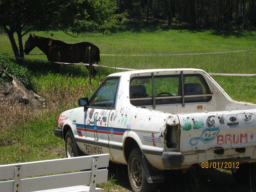

retired !!
Oh yer with the change to 98 octane no pinging and she reved right through to redline in the first 3 gears. 110kmh in 3rd easy as and no smoke blowing.
