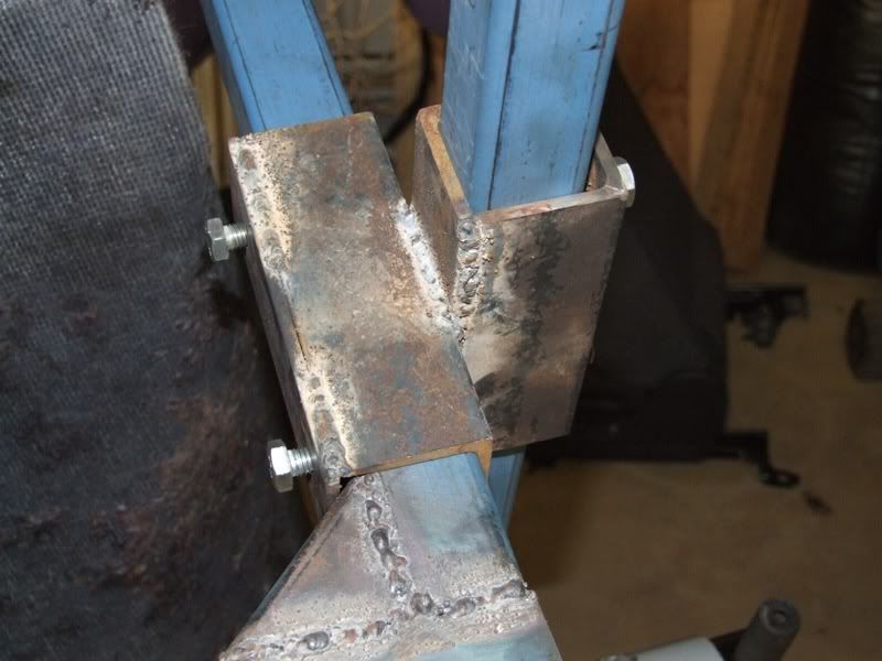

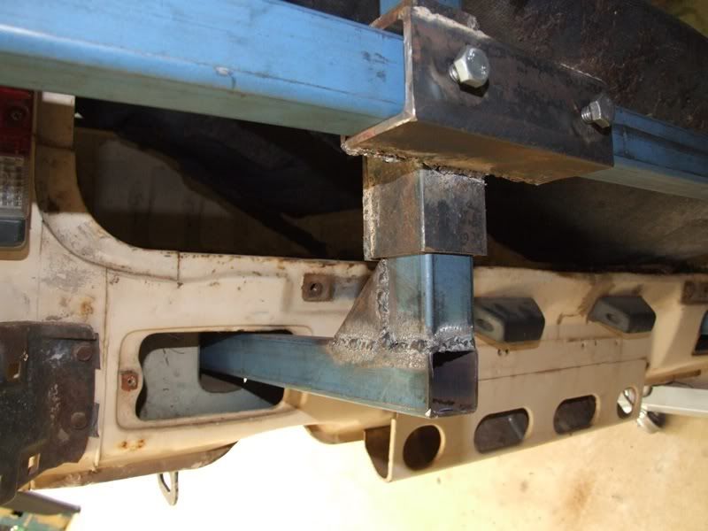

Here are some photos of my home made set up - bought 2 cheap engine stands from SuperCrap, a few bits of RHS and some welding and hey presto :
Cost me less than $200

niterida wrote:True - make sur you take out your perfectly good windscreen before you go putting a car on a rotisserie and spinning it upside down or it will likely crack :(
looks good the supershit stuff holding up alright

Great idea & well done except for 1 thing...please extend those legs! With the welding you've already done it would be easy to make the base wider. I'd go for at least as wide as the car you're putting on it. To not do so is like working under a car supported only by a single jack...its just asking for trouble!
Otherwise great idea & nice work on the supports.

nachaluva wrote:Great idea & well done except for 1 thing...please extend those legs! With the welding you've already done it would be easy to make the base wider. I'd go for at least as wide as the car you're putting on it. To not do so is like working under a car supported only by a single jack...its just asking for trouble!
No real need - it is super stable as it is and you only ever work on it from the side - not underneath it :)

That engine stand roti, I honestly gotta say I'm impressed two of those were strong enough, but I suppose with a completely stripped body it only weighs like 650kg or so... It is ingenuitive

Phizinza wrote:That engine stand roti, I honestly gotta say I'm impressed two of those were strong enough, but I suppose with a completely stripped body it only weighs like 650kg or so... It is ingenuitive
I've thought about this sort of setup but didn't get any further than this. If those engine stands can hold a 454 big block chev as I imagine they would be, two of them would handle an MY or L series body just fine!
The tricky bit would be jacking the body up high enough to bolt it to the rotisserie ends... Fun fun!
