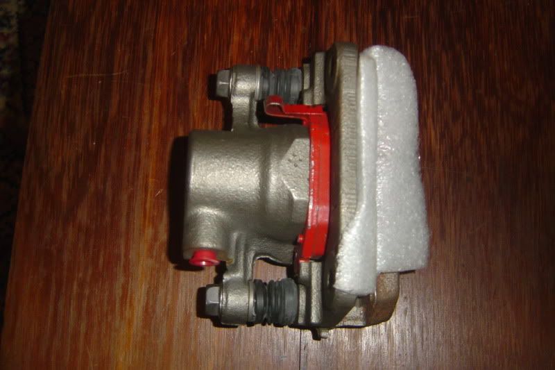

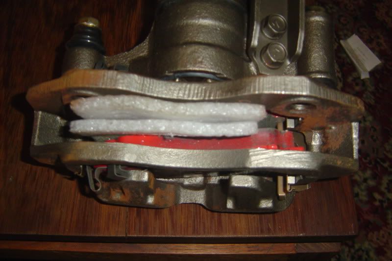

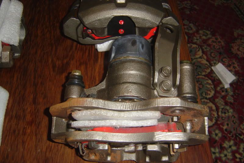

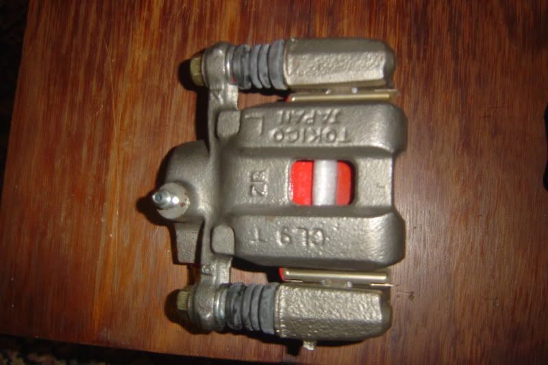

Brake calipers finally arrived today. Everything that could be replaced is new, and most importantly the handbrake mechanism is nice and smooth with full movement. The brake rebuilders couldn't gaurantee the handbrake would be repaired on my old ones, so this seems like a good way to go for comparable cost.

Oooh... New rears as well!
Paint going on them Guyph style? :mrgreen:
Will you be getting a new master cylinder, braided lines and new solid lines as well???

Yea the rears were probably overkill, but i think they only worked out to about 1/3 of the total cost. $380 for all 4 posted to Aus with the pads. I got quoted $400 to rebuild just the fronts and $250 at another place. Both quotes didn't include pistons, and obviously they don't replace all the slide bolts and bleed nipples which are new with these calipers.
If everything else is in servicable condition then it can stay as is, in some sort of attempt to control cost...
