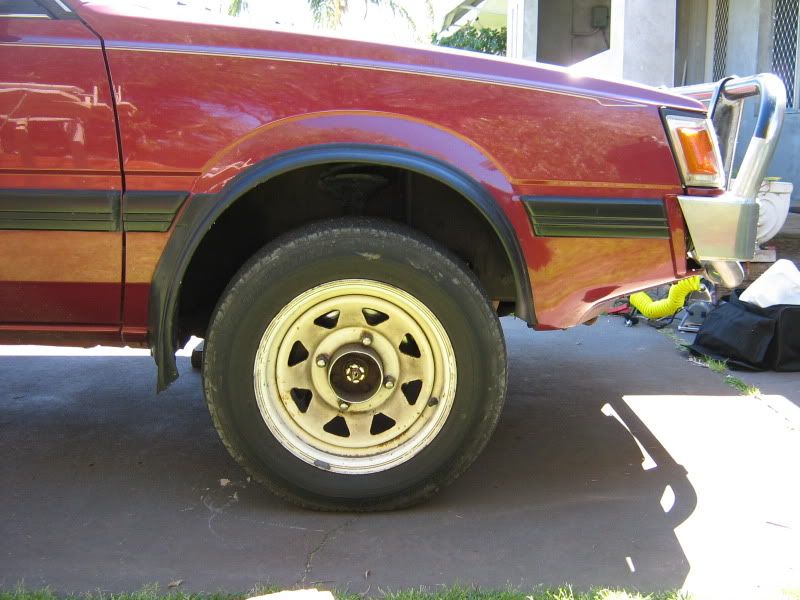

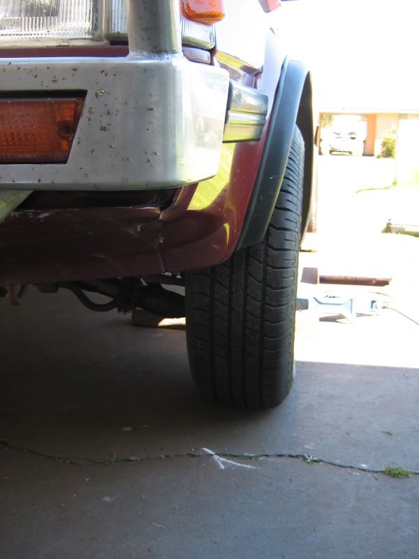

Post by 2nd Hand Yank » Sat Oct 08, 2011 1:18 pm
pics
