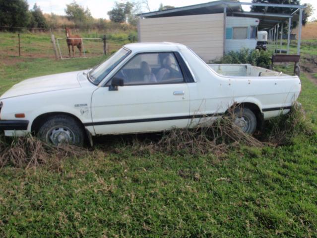

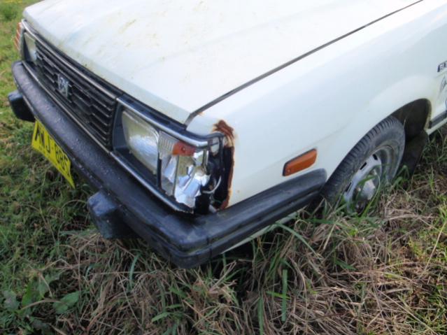

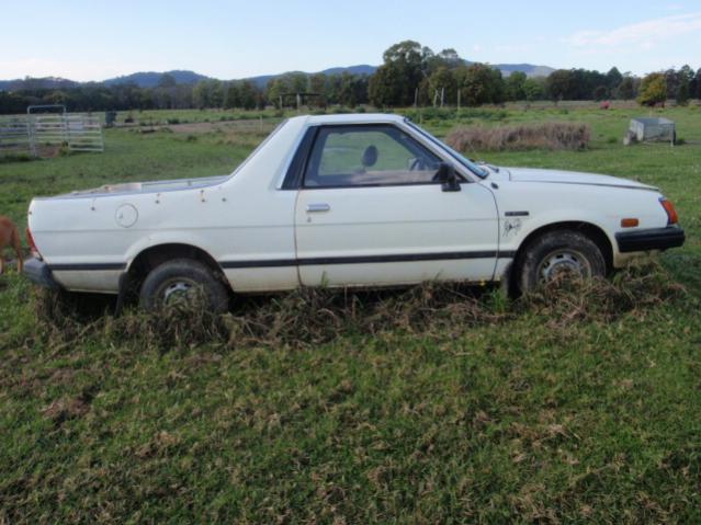

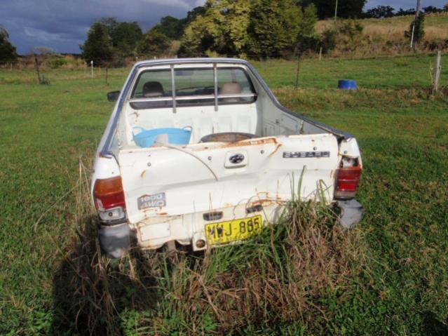

I bought it but can't pick it up for another week or so cause I need to borrow a car trailer, Me mate has his at Willowbank this weekend.
Should be able to utalise some parts and sell or pass on the rest.

Post by sven '2' » Thu Sep 08, 2011 9:41 pm
revmax wrote:LOL dofyl. Brumbys are almost extinct up here as the metal recyclers are very active.
Not a barn find, but a paddock find!
Howmuchwazit?

sven '2' wrote:Not a barn find, but a paddock find!
Howmuchwazit?
Not much but getting it home will cost a day and probably $150.
I realy only bought it for front pannel, Bonnet, doors and ignition barrell.
The tyres are all good so that is a bonus and anything else I can salvage is a bonus.
Yer the battery is RS. The was kept under cover untill January this year when the owner fell off a horse and busted her collar bone and the car hasen't moved since.
Not going to look at the motor until I get it home, do an oil change n stuff like that. I don't want to attemt to start it just incase it has a stuck valve from sitting and busts a pushrod. The water pump could be seized as well from sitting so I will have a carefull look at that.
Once I am happy with the motor, Gbox and Diff I will sell them as it has only done 182,000k's
