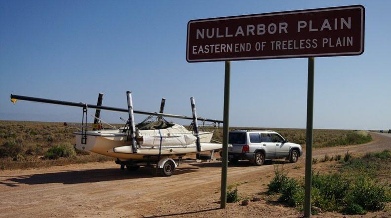

Hi All,
Thanks for the advice on the towbar and Tranny cooler.
I ended up going on a small "road trip", driving to Lismore NSW, then towing a boat (950kg) back to Perth. The old Forester ran like a dream. I have recently also towed the boat up to Shark Bay and back without any dramas.
Mike.
Mike.
- MRA_3576_s.jpg (51.47 KiB) Viewed 2844 times
You did what !!
