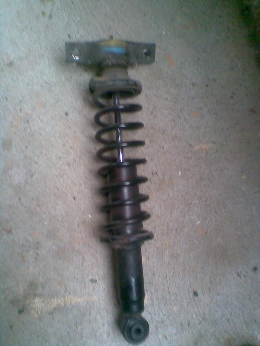

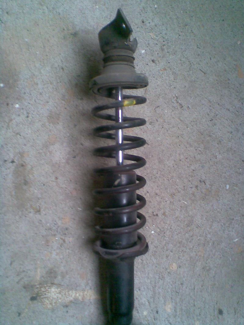

I dropped in and had a chat with Nev's dad this arvo and noticed a spring/shock assembly with a yellow dot on the 2nd coil. He didnt know what it was off, but I grabbed the part number off the side of it, interestingly, its not a KYB, but a TOKICO. Part No. 2007GA092
Could it be that the TOKICO shock on an RX has the higher valving rate of the KYB on standard L's?
There was also another spring/strut with an orange dot on the second coil, KYB part number, 21106GA260

Post by Gannon » Sun Aug 28, 2011 11:05 am
Yeah I should have made that clearer, the part numbers were of the strut only.
The yellow one is of unknown origin, but John (Nev's Dad) only has the one, Nev has the other one. The orange one came from a Vortex, but has white paint on it, suggesting it came from a wreckers
Can anybody else with original rear shocks check if they are KYB or TOKICO?
I did manage to take a photo with my phone of the strut.
It also had a yellow and a blue stripe on the top mount

Getting further - Neville has measured his orange dab as 9.90mm wire thickness and stands free at 285mm
My yellow dot ones most likely RX ones also stand at 285mm. YAY you say??
Not yet, as yellow dot wire thickness is 10.40mm
The two dot wagons springs are 10.80mm wire thickness
