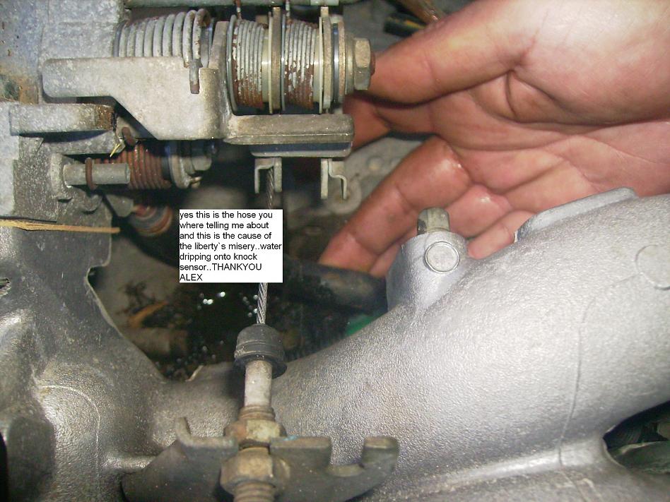

the knock sensor will retard the timing if its faulty as a precaution. Meaning you will have a noticable power decrease.
if there is water coming from your timing belt area (the plastic covers) there is every chance the water pump has crapped itself.
Otherwise look for pin prick holes in your hoses whilst the motor is warmed up and under pressure. Its usually pretty easy to find a water leak.
Also there is a water hose which runs right next to the knock sensor (under and to the right of the throttle body area) this could be spewing water onto the sensor making it throw a code. This has happened to my sisters earlier liberty before.

Iam back!... hmm , today i replaced the water hose above the knock thing and found another leak on radiator hose so replaced it.. all good so i thought, filled the radiator while car was running then put cap on, leaks all gone but! waited another 10 min or so while car idling, checked temp gauge fine so removed radiator and a 6 inch wave of water pushed out radiator but the water was not hot! i then tried filling radiator but it wouldnt take any water so thought bugger this and put radiator cap on and took it for a 5 minute drive and 3min into it i could see the temp gauge rising to boiling point , so pulled up at home removed thermostat threw it in pan on stove and it works. i also checked oil for water but it seems clear. think i bought a lemin eh, Could you please give me some idea on what the heck is going on .. p.s i tried connecting the housing where the thermostat lives but it leaked severely , i removed it and couldnt see any gasket, does the thermostat act as a gasket or should there be no gasket.. Thankyou for your time in advance ..
