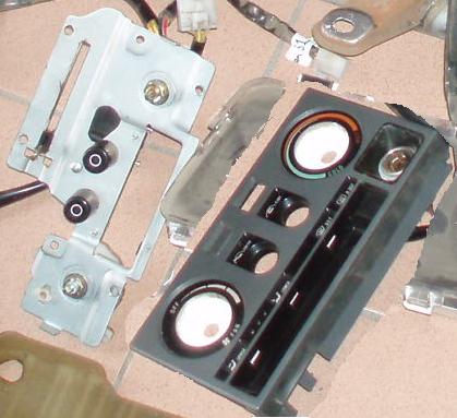

Post by 555Ron » Mon May 30, 2011 1:20 pm
Tozzy, when you remove the dials, you will need to undo the nuts holding them onto the plastic fascia. IIRC, there are only 2 screws on the bottom holding them on - plus the 2 larger nuts on the fan and heater control. The controls are firmly secured to the sheet metal behind the fascia and won't spin as you undo the nut. Once the plastic fascia is off, It becomes pretty obvious which screws to undo.

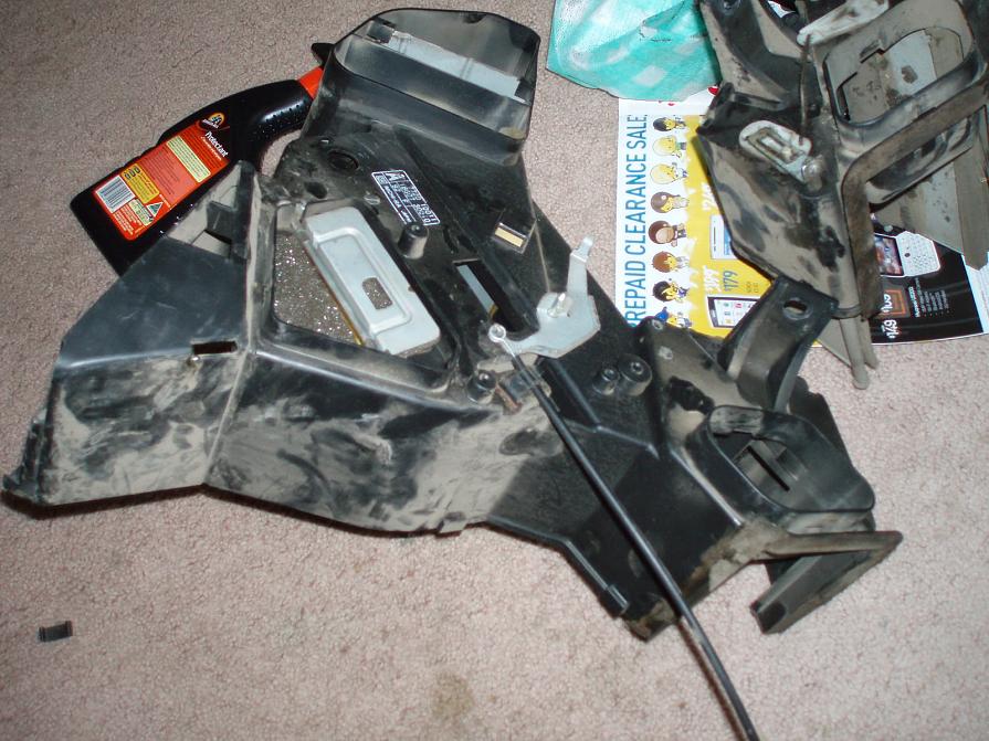

I attached some photo's of mine when i had it out. The picture of the heater unit shows the cable that runs to the heater knob, on the other side of the pivot is the cable that runs through to the engine bay.
You might be better off cutting in a ball valve in the line in the engine bay and switching it on in winter and off in summer?
