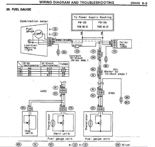

I'm 99% sure the second one (passenger side) is for the low fuel light, it usually comes on at exactly 9L whereas your main gauge can read whatever it wants and usually does.
Replace the one on the drivers side with a second hand one or try cleaning the contacts in thinners or with some contact spray, I wouldn't bother with a new one.
The sensors are wired in series and measure an average of the levels of fuel in the 2 sides of the tank.
Fuel light has its own sensor (wrongly labelled 'thermistor')

Low fuel light is on drivers side.
Sandpapering or cleaning the contacts works 50% of the time, doesnt last long.
