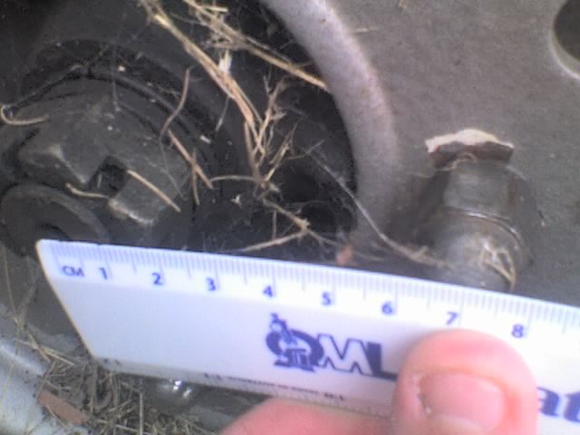

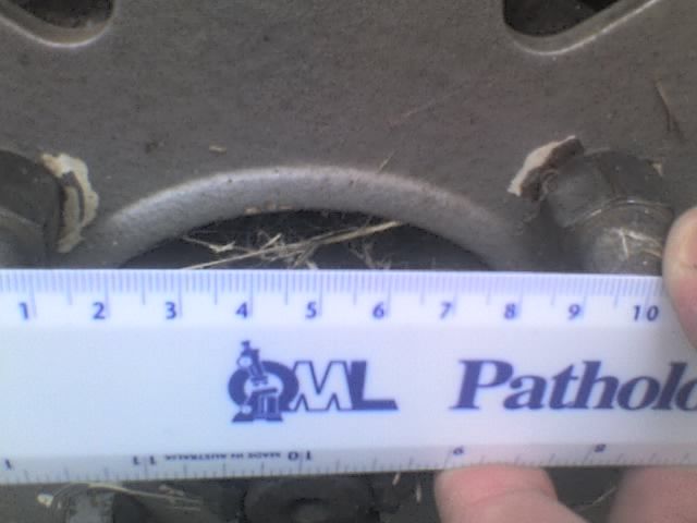

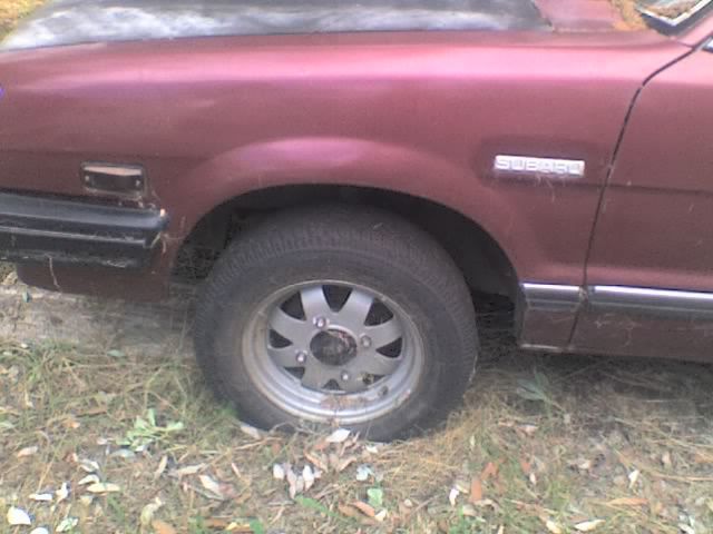

This is the old wagon, its the only one I could get accurate wheel measurements on.
This is the bolt to bolt measurement, exactly ten centimetres.
This is the center to bold measurement, seven centimetres.

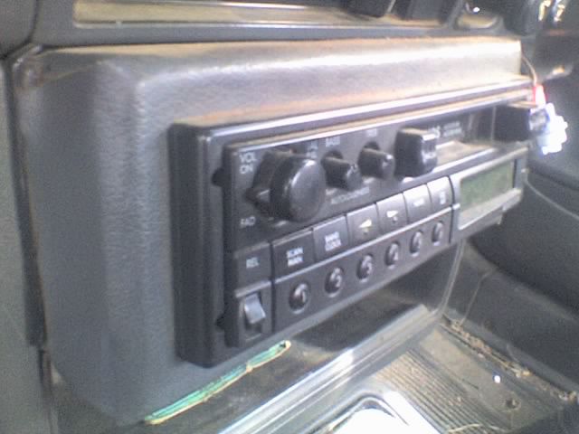

I put some lino onto the head unit fitting, turned out nicely.

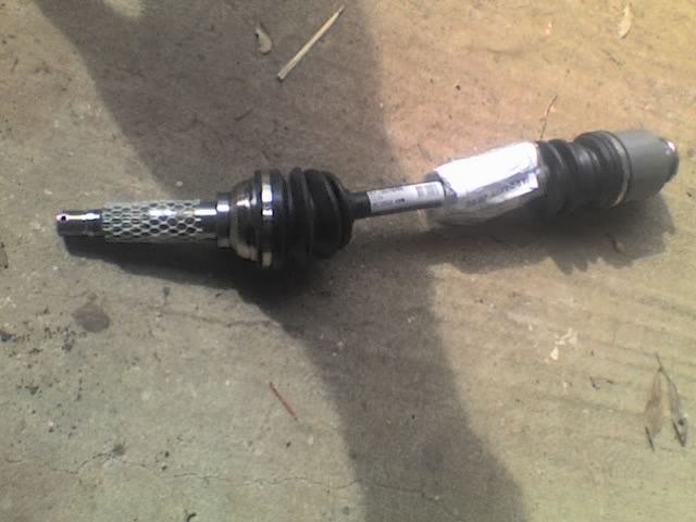

New CV joints I bought, about 350 each. (Brand new.)

And, this is probably the most fitting rim I've found.
http://www.speedywheels.com.au/images/z ... nmetal.htm
With those specs, do you reckon it would fit?
bluesteel
Posts: 892
Location: Hobart, Tasmania
Post by bluesteel » Fri Apr 07, 2006 9:47 am
on you hubs at the moment... not a chance
can either get the hubs redrilled to suit a different stud pattern (Probably Illegal)
can get adapters made up that bolt onto your hubs and have new studs coming out to suit a different stud pattern (probably illegal)
or you can buy bratgeebah's kit when its all done and do it properly (comes with engineers cert)
