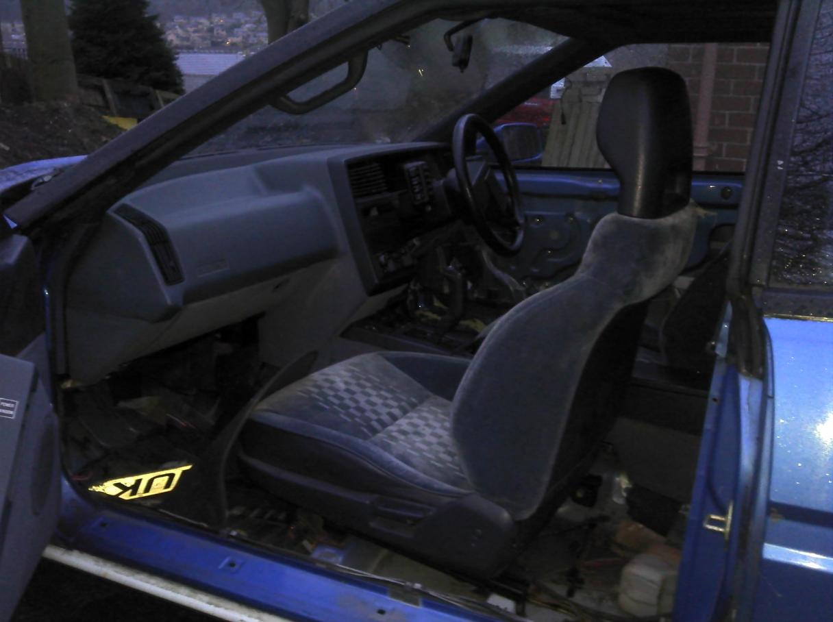

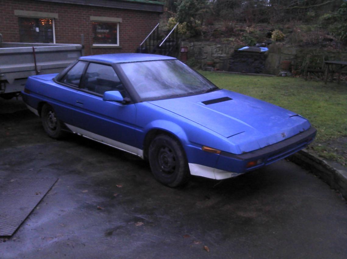

Here is the scrapper. Just going to strip off what I need and some other stuff and away it will go to the Subaru scrapyard in the sky ! (its rotten see and its had the engine and rear discs robbed before I got it)
[ATTACH]2624[/ATTACH]
Here's the inside - it was an Autobox.
[ATTACH]2625[/ATTACH]
