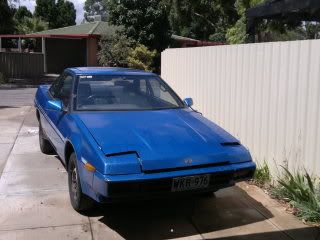

Post by shuffbag » Sun Feb 20, 2011 8:19 pm
well here's my vortex, its running..
no engine
no box
4wd rear end with the 2wd shocks (thats why its sitting high)
