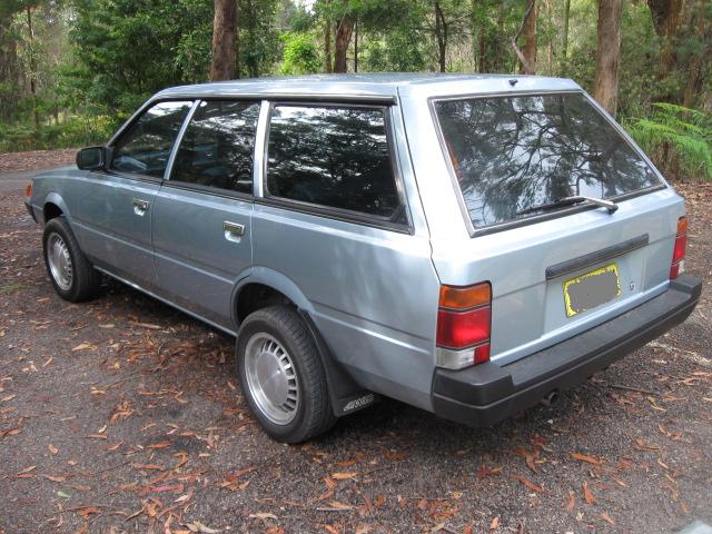

Yes me likes to! For now will have to settle for my not so compliant "rims" :(
I aint going to fork out 1G for scratched up Scorpions with a tyre brand I would never touch.

I believe they are about the only compliant 14"'s for these cars. I could almost justify 1g for a brand spankers set of 5 all to my own. I have not yet yet recieved a reply from Scorpion about another product run for these:(
Post by sven '2' » Fri Jan 21, 2011 10:08 pm
FujiFan wrote:Yes me likes to! For now will have to settle for my not so compliant "rims"
Nice wheels but.
Just needs a little flare as discussed recently in other threads to satisfy the protrusion concerns.

Post by FujiFan » Fri Jan 21, 2011 10:24 pm
Have considered flares or guard rolling.
The tyres are Toyo F600 R14/60/185. Very nice gripping tyre, good in the wet, Have survived the occasional unsealed abuse and some:).
