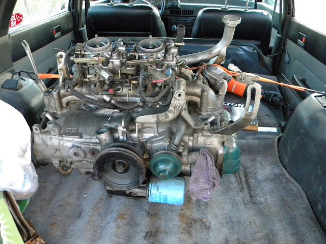

Anything like these?
This is of an EA62 engine from the FF-1 Coupe, 1.3L and made 92HP and 7000rpm
EJ22 with dual IDF's and a different distributor setup (looks like its an electronic distributor with a remote coil pack)
Another EJ22 (well heads) with dual webbers
nope
more like the duel carbs on the ej22 in VW
im chasing specs from the guy in NZ and maybe even more pics or somthing

i dont want them sven i want the safari set up =)

A kiwi fabricator / welder ...Dunbar was his name, once told me of the safari kit avail from Subaru in NZ the carbs were more directly over head ports
