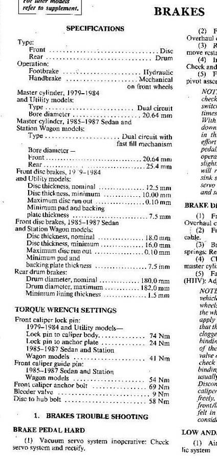

I cannot find the torque spec for rear or front hub to brake disc rotor bolts. Funny feeling Gregories manuals have it for fronts 14mm head, M10 thread. Not find my Gregory or in factory manual - odd
anyone got specs on L SEries for above?
ta

Post by olddog642 » Fri Jun 25, 2010 2:10 am
Not sure if this is a help but check it out
Hylton
Manual Gregories.jpg (68.31 KiB) Viewed 1735 times
Manual Gregories 001.jpg (96.77 KiB) Viewed 1739 times

I would have said FT setting but 58nm works for me :D
One thing is to make sure both mating surfaces are clean and rust free :cool:
Post by steptoe » Fri Jun 25, 2010 10:20 am
58 converts to fot lbs for me on the 'net, then I scratch it into the manual you have there olddog, dunno where mine is .....
They are same size thread the front hub bolts so that will do nicely, thankyou. The holes do not line up front disc to rear hub - nice bit of idiot proofing for the trivia buffs.
New disc rotor is shiny as and the hub has been wire brushed and painted up. Thanks all
