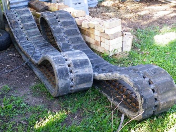

All excellent advice...and for the fearless
[ATTACH]1849[/ATTACH]
showthread.php?t=13027
