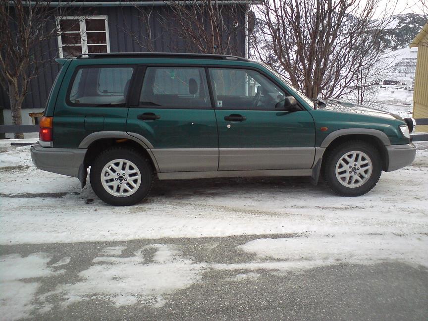

Hello, I'm new to this forum. I love my Foz. It's a great car. And even tho I have owned it for barely 1.5 year I'm still amazed by it's awd system in snow.

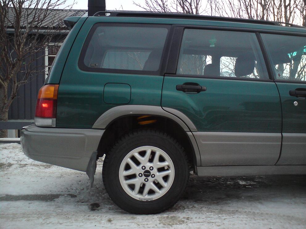

It got 202000KM on it now. I changed the rear suspension with raised king springs from Australia. (with kyb struts) And I just changed my 75amp alternator that was not all healthy with a 110amp from a US wrx 2009. It works great. I also waiting for stuts and raised king springs for the front. I have replaced the plastic undertray with a amataur made 3mm allu skid plate.
S-Turbo SF 2.0L 1999 AT. Kybs & Kings. 110A alt.

awesome.. Nice ride you have. Are these rims foz's rims or after market?

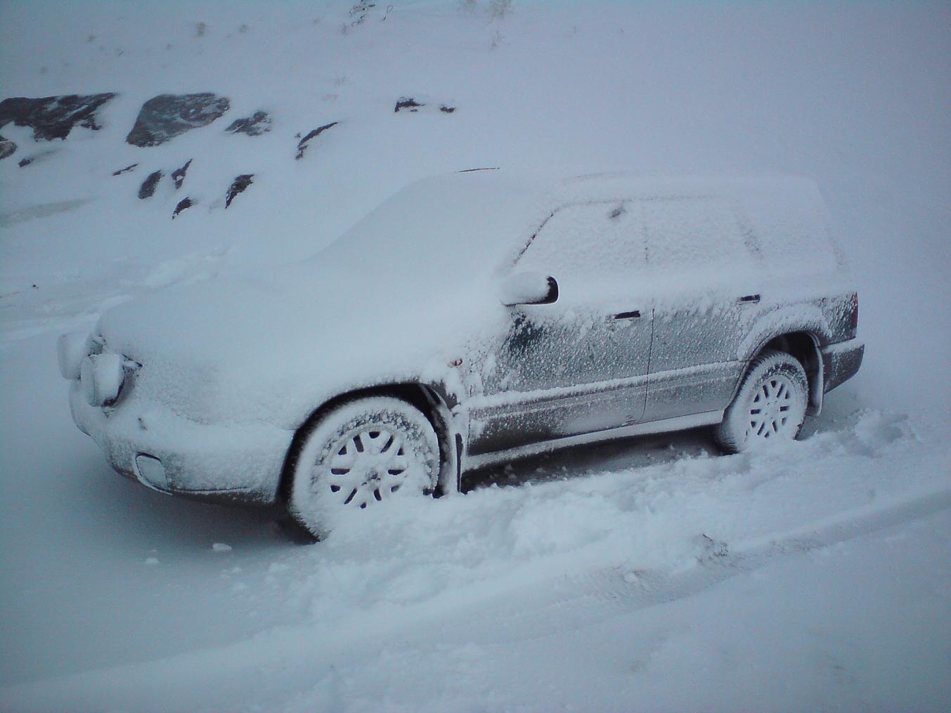

Makes me cold just looking at the second picture. Welcome to the board.
Post by steptoe » Wed Apr 22, 2009 1:08 pm
I was thinking similar...BBrrrrr

Curious as to the temperature at the time of the snow photo, and as to what concentration level of anti freeze used in engine. Did Subaru fit any warming device to diffs or gearbox etc for your extreme cold winters?

1: That are the rims following the car. factory rims
2: That pic is more of the combination of snow and wind. As for cold it may have been around-5celsius.
Not much heating to the diffs or anything. As standard we got ofc heated seats, wiper defroster and outermirror defroster. Not sure where in the world this is standard.
3: We use 35-50% mix coolant as far as I know.

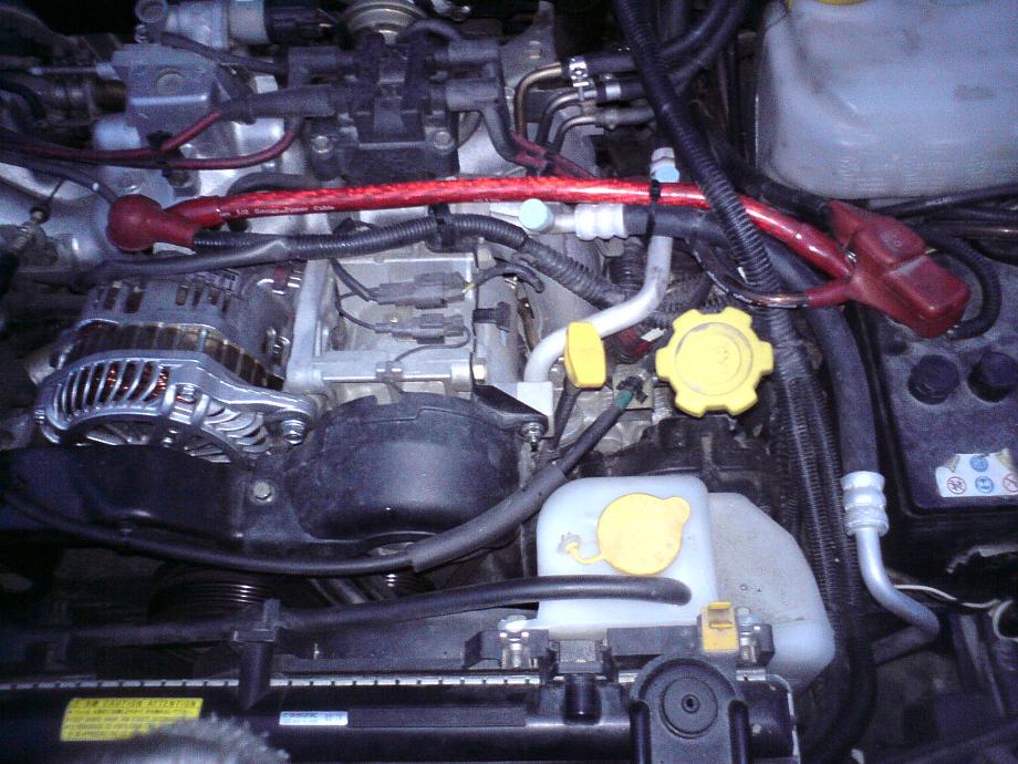

This is my new alternator installed with a small extra power wire :p
The alternator is only 110 amp. The wire is of the type 1/0 gauge or 50mm.

That would help big time, have you placed bigger gauge wire from body (negative) to battery and also from battery to starter motor will help in the cold.
With the headlights and spotlights it would be ideal to re-design the wiring with relays instead of using factory wiring (it stays the same but add relay for heavier current.)

I haven't done the ground wire to the starter engine and the lights, no
Edit: You do know the wire is rated for almost 3 times the load....It called oversized.

Anyway, I'm going to replace the starter today. The original one is tired. SO maybe I can ground it then ;)
