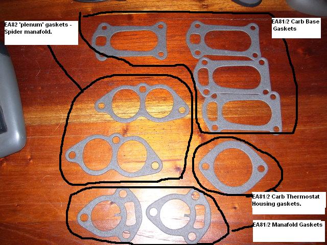

I don't think they are any of those gaskets , the MPFI inlet port ones have two main holes and a water one from memory .
OMG , stupidity cells have just kicked in .
God help me , the inlet port gaskets are Pt no 14035AA160 and I've had them for a week or so ...
I've just been looking at mine to compare with the ones in the pic above and the coolant holes in mine indicate inlet port gaskets , the ones higher up between the injector stub pipes and the plenum/collector section don't have water holes . The the water log connects the stub pipes behind where the upper section bolts on and with separate gaskets .
Dipstick mistook the gaskets below the stub pipes for the ones below them .
No wonder I thought it strange that spider specific gaskets were available locally but not the common MPFI/MPFI Spider inlet port (to heads) gaskets .
Thanks all , cheers A .
