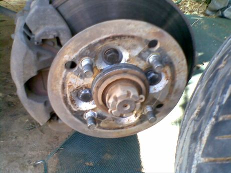

Will check to see if hubs redrilled , have a spare ROH standard 13 inch laying around a mates house , I just hope that fits , cheers

[ATTACH]1435[/ATTACH]Cheers just checked and hubs are re drilled , thanx 4 that advice

Post by Kalbarri_baru » Tue Mar 31, 2009 6:11 pm
Yes they are redrilled hubs
[ATTACH]1436[/ATTACH]
makes it harder now to decide if I get new hubs or re bolt them to standard Subi patern , sell rims with hubs or find rims suited to 4wd in the new stud patern , any ideas ????
Post by Gannon » Tue Mar 31, 2009 6:23 pm
The studs are definitely too close together to be 140mm PCD
Matatak
Posts: 2393
Post by Matatak » Tue Mar 31, 2009 6:55 pm
thats coz they are now 4x100.
if you want to get normal Subaru wheels knock the studs out then put them back into the outside holes.

GOD
Posts: 754
Location: Tom Price WA
Post by GOD » Tue Mar 31, 2009 7:04 pm
Measure the centre to centre distance between two diagonally opposite studs. If it's 100mm or 114.3mm, you should have plenty of choices in wheels. See http://www.retroridescommunity.com/whee ... &submit=go
Or if you prefer Sunraysia-style wheels, it's easy enough to knock the studs out of your hubs and move them back to the original 4x140 holes.

Kalbarri_baru
Posts: 230
Joined: Sun Mar 29, 2009 9:47 am
Location: Kalbarri W.A
Post by Kalbarri_baru » Tue Mar 31, 2009 9:58 pm
Well that settles that then , looks like I knock out studs and place them back in subi patern for some Scorpion 14 inch rims , cheers all for the advice ;) ,
