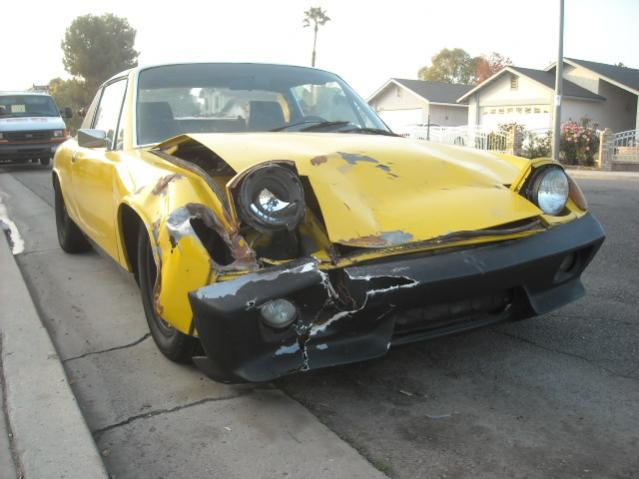

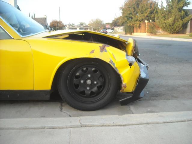

Im new to the suby world and id like to know what can you do to the EA82 engine to safely put out about 200hp-250ish hp, or is that a redicoulous request? im currently in the middle of rebuilding the front end of my 74 porsche 914 after i rear ended somebody about a week ago. ouch!!! so i want to do a suby conversion to an ea82t engine. they are liter than my 914 engine and i cant hardly get any power out of my engine. my engine weighs approx 300lbs and i was looking around for the weight figures, and i saw that the svx engine weighs around 285lbs. is that correct?. well if it is im sure the ea82t is much liter. also do the ea82t engines require vavle adjustments? and if so how long between adjustments. id like to know as much as possible about these engines so feel free to let me know anything i should know. and if my info is wrong let me know.

Tell us more about this Porsche

well my porsche is a work in progress. im tired of my car looking somewhat quick but not being able to take even the lamest of civics. right now it has a 1.8 type 4 vw motor. probably 85hp stock. i have a custom exhaust whic i estimate to boost it too about 100hp along with the 2.0l intakes and throttle body.i got it about 5 years ago. i just recently put in a sway bar in the front, these cars didnt come stock with sway bars. big improvement in cornering/handling. i have lowered the car, about 3 inches in the front and about 2 in the back. this car is the product of a colaborative effort between vw and porsche in the during 1969-1976. between 70-72 porsche put a more powerful 2.0 6 cylinder that produced 125hp. those are rare and cost a pretty penny if they are in good shape. these cars came with fuel injection stock. and i still run the fuel injection. there is the l-jet and d-jet tronic fuel injections, i prefer the l-jet, it has an airflow meter box instead of a vacuum regulater to control the mixture, the l-jet is much more accurate with fuel metering. i have heard a lot of guys say the stock fuel injection is crap, which is totaly not true, they make it crap becuz they dont know how to take care of the FI system. the porsche 914 has 4wheel independent suspension, 4wheel disc brakes, manual 5 speed, no power anything pretty much. the front suspension is a single torsion bar wishbone set up with mcpherson struts. it has rack and pinion steering. the rear suspension is coil over shock setup upt mounted to a trailing arm, the car is a unibody making it pretty light. my car only weighs about 2000lbs. thats just a general overview of the car. oh one more thing. the type 4 vw engines are heavy for their size. they weigh about 300lbs which is crap. anyways id like to convert to a suby engine because some variants are lighter and produce more power and are more tunable.
