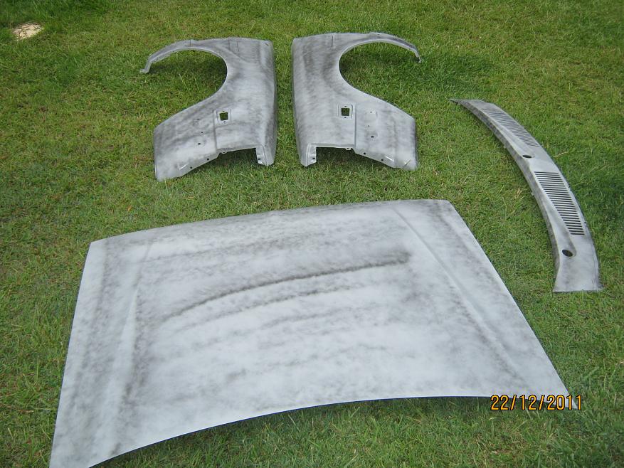

Guards, bonnet and grill have been welded, spray filled, rubbed back, 2pac primed ready for another rub back and some more prepin.
Have been doing this over the last few days and finished one guard and grill today. I am not realy sure what the next step is. i think I am ment to rub the pannels back with the orbital sander again. The black dust coat will show the remaining low spots and I think I am supposed to use good quality boddy filler or spray putty to fill the low spots then sand it back again.

Yep that's it...just many rounds of dust coat, light sand, fill in the low points with spray putty then do it all again till your satisfied with the result. Lots of elbow grease & patience :-D
