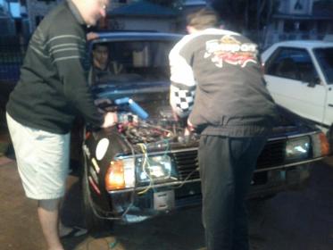

On another note........It's Alive!!!!!!!!!!!!!!!!!!!!!!!!!!!!!!!!!!!!!!!!!!!
Yep that is right, thanks to help from "little white ute" tonight the beast roared into life. A testament to the rebuild of the engine and a wonder that we managed to get it together in a somewhat correct way :eek: but it turned over nice and easily and I couldn't imagine it going too much better.
So a big week or so coming up, alot of work inside the cabin as it is still pretty much stripped and then some finalising in the engine bay and we are up to road test time....
Good thing there are only a couple unknowns to test out in one drive
Brake System (Rotors, Pads, M/C, Lines, Rear conversion)
Gearbox - Complete unknown has had some work in regards to shifter but who knows how the gears/synchros are
Engine - Sounds brilliant but still new everything to test out
Thermo Fans - still toying around with the set ups although they seem to work effectively
All Electronics - Finally bit the bullet and got an auto sparky out to test some of the circuits today and definitely don't regret it.
Completely new interior including seats, door cards, sound system, electric windows
[SIGPIC][/SIGPIC]James :D
